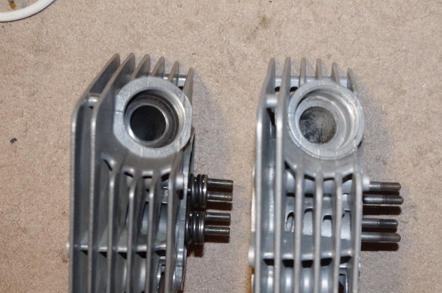

It so happens I have boxes next to me with 77? Strada heads and ?? Kanguro heads. Bad photo attached.
The only difference I can see is an extra casting 'lump' on the kanguro head (on the left) and a 'flat' on the top of the exhaust port. The rocker stud threads also seem longer (though the studs are the same length) - but they might be replacements.
The Forgotten Error has one 'old' head and one Kanguro head. So far as I can tell they are interchangeable - but perhaps the 'flat' on the port is vital for clearance if in a Kanguro frame?

Ah. There is also more 'meat' round the exhaust port on the Kanguro head (left). Not sure why. Perhaps makes for a better thread, or better cooling.?

The size of the valves of some Kanguro heads are diferent (guess the ones with Gilardoni barrels) don´t have the dates "a mano" but at least one of them is bigger.

Ah, it looks as if the exhaust valves could be a bit bigger in the Kanguro head, but hard to say without getting the vernier gauge out. If they are, then the 'nice' pair I have will be going on the Forgotten error for next season!

Well after dismantling one of the Kanguro heads as the start of this years winter project, it appears to have exactly the same sized valves as the earlier heads I have. Inlet 30mm and exhaust 22mm. The exhaust port seems the same size (25mm or so), just more meat round it. The valves and guides are in nice condition though and no trace of a crack between the seats. The exhaust port threads are perfect on both, so these are definitely going on the Forgotten error for next year.
