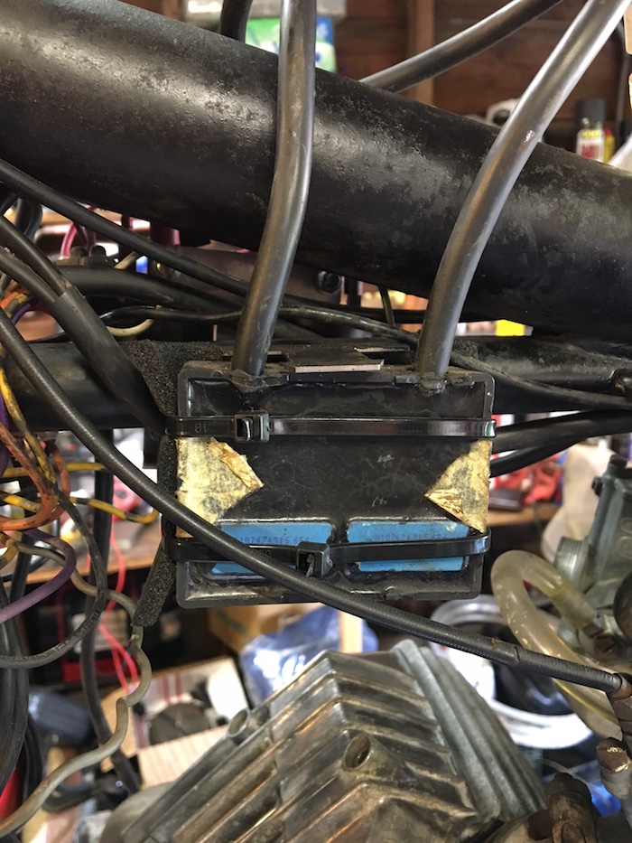

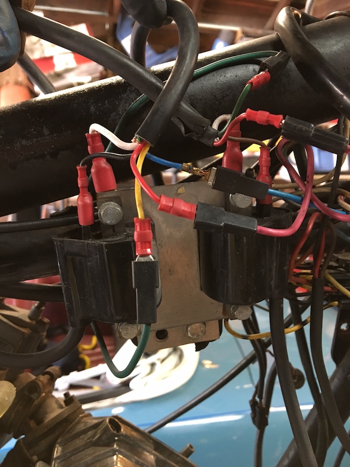

My 350's PO did some wiring mods and I'm a little confused about how it's supposed to go. The bike ran when I got it, but didn't have a battery or key/ignition switch (at least not a key) - nor did it have any kill switch. I put a key switch in - 4 terminals; I doubled up the grey and brown accessory/light wires just to get it going. Green goes to alternator/stator and the red winds up at the battery both via the fuse panel. The blue (ground)isn't used, the switch grounds itself.
Now, with the key turned on, I get 12v to the lights (br and grey) and the green wires where they end up at the ignition pack, but after I got things squared away, now I have no spark. After some reading, I think I have a different setup and hopefully haven't fried it with the battery.
I didn't make any drastic changes, just cleaned it up and figured out what was what. I'm hoping I just grounded something that wasn't supposed to be (the missing kill switch) but I'm not having any luck. This pickup/transducer setup is a little foreign - every way I know how to test a points system doesn't work.

First thing, that ignition system is not the Morini original. It looks a little like the NLM system BUT! it isn't quite like the NLM system I have on mine. So possibly another persons work if not a earlier/later version of the NLM type.
The important points are;
1) You don't want 12 volts anywhere near the transducer/black boxes! The Standard and NLM system is self generating via the flywheel/stator.
2) If the components are good, then make sure your green wire is not earthed. That is how the standard system switches the ignition off.
3) All the stuff you know about points and coils is irrelevant here!
4) If you have given the transducers/black boxes 12 volts they will most likely be fried, as you said.
5) If you don't have a full understanding of the system and some very specialised kit you won't be able to test much of this other than by substition.

That looks like an NLM "two cable group" module with separate coils. I'm running that on the hill climb bike. The road one has the earlier one cable group box.
The green wire from the stator should go to just the green connection on the one cable group. The yellow is for the electronic tacho. The ignition switch should short out the green to earth via a branch IYSWIM. There should definitely not be 12v to the green connection on the module! You may have fried the gubbins in that, but I'm not sure if it uses the same thyristor system as the OEM setup, so if you redo the connections correctly you might be OK. I've got an idiot sheet somewhere that NLM produce. Aha! Scan attached.

By the way. The NLM instructions reference to "black from pick up" is for their own pickup. OEM will have red for both cylinders but the front cable should have a white tag to identify it. From your photo it looks as if you have an OEM pickup of some type.
