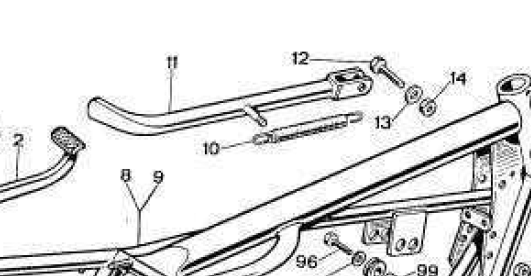

The bolt for the side stand should be shouldered with the stand pivoting on the shoulder. The spring is attached to the stand onto a peg the other end is attached to a steel clip which looks similar to a ring pull or a half a Ying/Yang shape. If you have this clip and the shouldered bolt then it is possible without too much exertion to, with the spring attached to both ends and with the stand in the stowed position, to just get the bolt to start into the larger shouldered hole and then be able to thread the bolt into the thread of the frame. Yours has probably been mangled by a previous owner who lost the clip or did not work out how it should go. Have a look in the parts catalogue where you can see the blown apart components.

The clip description makes sense, but I have no clip, nor do I see one in the catalogue. I'll try Pedro's lever method, and I'll ask about the clip next time I'm ordering from NLM.

- Sidestand.PNG (106.8 KiB) Viewed 14030 times
Re: Sidestand spring?
You find this clip, well not the clip but how it is on Andis web. There are a lot of interesting downloads
Scroll down to "Blech für Feder Seitenständer" and then have the right istrument to open it
