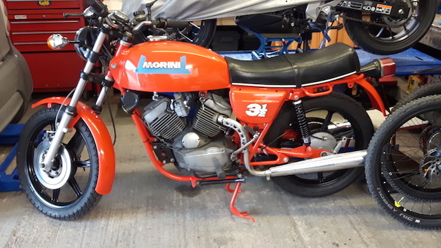

After more than 30 years this wee Strada breaths fire and lives again thanks to the assistance of Simon at NLM. I was unable to trace my errors in the electrics when rebuilding and at the point of throwing my Teddy out of the pram I resorted to the experts. Thanks to Simon he had it running in under 90 minutes. It still needs fine-tuning but the mere fact that I know it runs is more than enough for me to want to finish it. Its almost there and will hopefully be completed by mid December before I go on holiday.
It’s taken longer than I anticipated and a wee health problem in July took the wind out of my sails for a few weeks but at last I have a smile on my face again. That said I’ve still had my other bikes to maintain and ride in Spain etc. to keep me occupied when not working on the Morini.
Today I’ve rechecked the valves, timing and made a start on the carburation, which seems a bit rich based on the stink of my clothes. I’m sure it will take further fettling to get it somewhere near where it should be as at the moment it stalls at under 2000 rpm. Perhaps lowering the needles 1 notch will help. I’m at about ¾ turn out on the mixture screw and 3 ½ turns on the idle screw.
Next up will be oil change and oil filter clean although the oil in it is very clean never having run for such a long time I don’t think it will be up to much in the way of protecting the working parts.
If any of you knowledgeable gents want to throw some hints my way they will be very welcome.

Nice looking bike,like the black wheels put a few more pictures up when you can

Chirpy, I will put more photos up in due course.
This was only a taster really to let those who have offered advice and help along the way that progress is being made. The pictures do show it in a good light but it's strange in some ways
