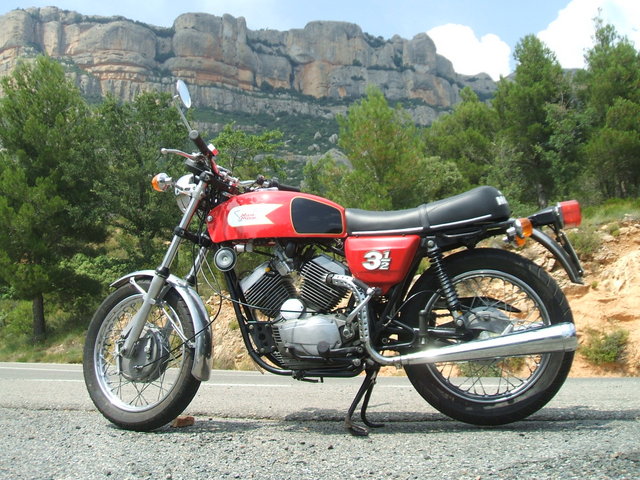

Hello .
I'm new to this forum but with long history with things Morini.
Last year I bought a 76 Strada here in Catalunya , Spain. It had been customised with cow horn bars and leather tassles.it was the filthiest and most neglected ( barely ) running motorcycle I've ever come across. My wife reckons my 6 month restoration wasn't much of a cosmetic improvement. 'Tart's handbag' is the phrase that springs to mind. It did go well though ... until the other day when it started running on the back cylinder only.
I soon narrowed it down to a faulty pickup (red)
This was a second hand item kindly supplied by Rob Koster of Morini Service N.L.
His help over the last 2 years has been invaluable. He rewound my stator ( now 314 ohms )and tested and supplied new and second hand ignition parts. I have to say his charges were very reasonable.
The red pickup lasted many months before playing up . I thought I was going to have to bite the bullet and shell out for a new one when I remembered I still had the old one that came with the bike kicking about somewhere. This pick up had the wider metal strips . I was told this was for the 350 Kanguro.
I fitted it this afternoon and the bike runs very well.
What difference will this pickup make to the performance of the bike and is it a wise replacement?
Any reply appreciated.

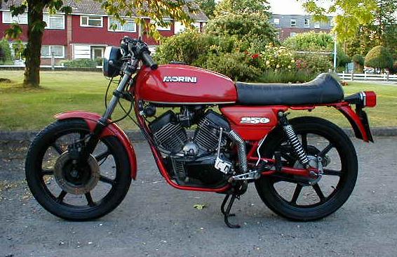

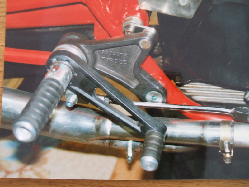

. . the 420/250 2C is still around and still mine, I'm the bloke you sold it to and I'm very pleased to have it . . I fitted clip-ons and re-made the rearsets so it no longer needs the displacer block, it also sports a set of Lafranconi competizzi reservato silencers and a cross over two into two exhaust system (front pot goes to the left rear pot to the right, both pipes equal length) . . I had to do a bit of re-jetting but it now pulls even harder and the exhaust note is pure vee twin music, makes a Ducati sound limp . . I also resprayed it to match the original frame paint and replaced the swingarm bearings and tyres . . next on the wish list is a better front brake and a fork brace . . . You might remember I was having a bit of a rough time around the time I bought that bike, I think having such a nice thing to play with got me thru those times . . . All the best to you and thanks for the bike .

Boris!
I'm glad you still have it, what a fabulous engine eh?
Can you post a picture of it? I'd love to see what it looks like now. Better still send me the soundtrack!
You are right about the rearsets,the spacer should have been meatier. It used to flex a tiny bit when pressing on...
As did the ex Benji Straw second hand 2 into 1 exhaust complete with riveted patches , the muffler blowing clean off at one memorable Cadwell, with not a murmur from any of the marshalls despite the terrible din.
We should count ourselves lucky that these great toys sustain us through the good times and the bad. All the best, and I hope to see the bike in the metal one day.

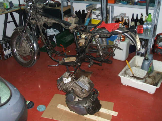

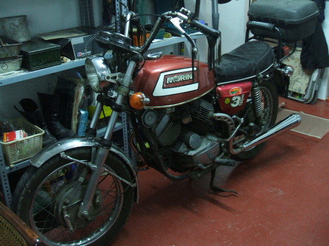

For Dom's delectation..72degrees wrote:Call me morbid, but I really want to see the "before" shots!
Dom
The concreted oil and muck together with the dry climate here did a pretty good job of preserving things. No rust.
I decided to leave the original paint on the frame, even though it had worn in places.
- poor picture but winged mascot riveted to top of headlamp, tassles on bars more tassles whiskering the rear numberplate , intake rubbers shot , no shocks, clutch mullered.etc..
- strada2.JPG (100.33 KiB) Viewed 18680 times
- notice the familiar bottles of 'degreasing agent' in the background...
- engine out.JPG (100.7 KiB) Viewed 18680 times
- always use COLD water and a degreaser.
- degreasing.JPG (107.24 KiB) Viewed 18680 times
