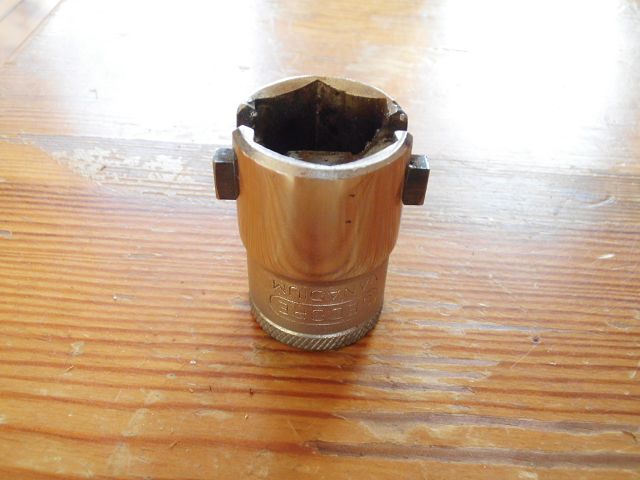

Recently I had the same problem. Normally these tubes are very dificult to get them out if wanted. And sometimes also to fit them. I´ve made a tool to be able to atack with a bit more power, using a"nut" that just enters in the tube :
