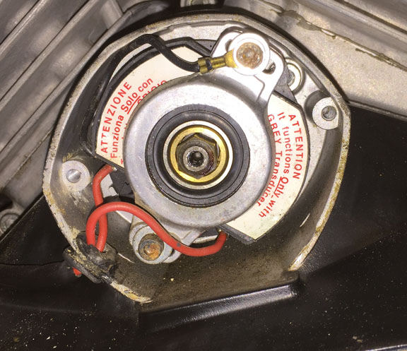

I ordered a pickup mainly in "poke and hope" mode in the absence of any other ideas, I must admit it was more expensive than I expected, the £125 quoted turning into £161 when you add VAT, post and VAT on the post! The next problem is that it doesn't really fit on this bike. Here is a photo of the OEM pickup in place:

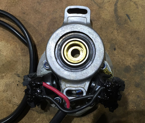

As you can see, there is an additional bearing for the camshaft, which bridges the pickup, and on the end of the camshaft there is a special nut with a square hole in the end, which engages with the tacho cable drive. The next picture shows the NLM pickup with the bearing next to it:

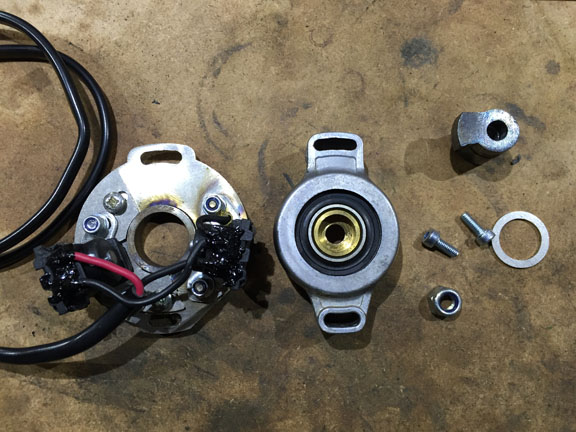

The bearing won't fit over the pickup, which is much deeper than the original:
The advice from NLM is to discard the bearing assembly. I'm kind of reluctant to do that because I can't help feeling that the bearing was put there for a reason. Has anyone else been down this path? Or can anyone throw any light on why that bearing was fitted on the later model bikes?

Well you learn a new thing every day. I've never seen that bearing outboard of the pickup before. My K sport didn't have one, the pre k bikes don't have them, and the post K kokusan ignition bikes don't have them. So we're they only fitted to the K2? I can only assume it was to Keep the pickup trigger concentric, and was then redundant when the pickup was moved to the flywheel.
The kokusan bikes (dart, Excalibur, New York, Cougaro) of course don't have a camshaft mounted pickup, but the tacho drive is still through the 'pickup' cover. On the kokusan bikes there is a small hex extension with the square tacho drive hole which screws into the end of the camshaft. I don't see why you shouldn't have a similar arrangement on the K2.
Sounds like you're getting closer to solving your problem anyway. Good luck!
