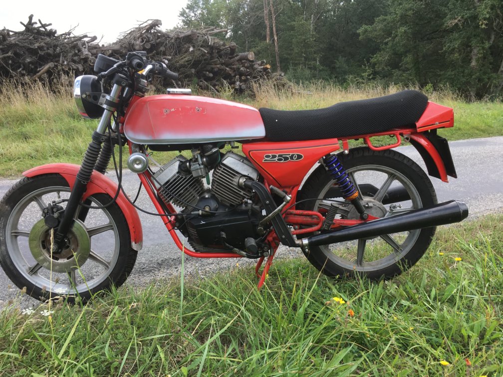

At last, more progress. After about 4 years of ownership I have done most of the little jobs required to get this bike back on the road. Went for a run this afternoon and am most impressed! A little gem. Still odds and ends to do, may even give her a paint job sometime...
In the meantime I'll try to get a few more km on the clock.
J lhs.JPG (242.7 KiB) Viewed 15685 times
J rhs.JPG (222.39 KiB) Viewed 15685 times
