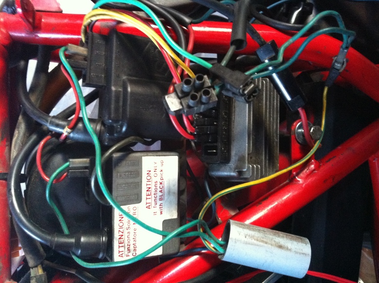

250 2C ignition
Hello folks, thought I'd slip this into an existing Topic.
I am puzzled by the transducer arrangement on my newly acquired 250.
The bike is fitted with a square grey transducer and a black Piaggio transducer, the pick-up is black.
Now the alternator feeds to the ign switch via the diode (as per wiring diagram), but then instead of going to both transducers it feeds the 'device' in the plastic tube, via the yellow / green wire, two green wires out to the transducers and a blue wire to earth. Using an ohm meter gives around 1M y/g to g one way and about 600k the other, for both the outputs (disconnected from transducers).
I can't think what it is for, I presume it's something to do with the Piaggio transducer. I think I'll try a couple of Vespa transducers instead. Any ideas?
Posts: 1568
Re: 250 2C
Aha! The 1984ish 2C project I'm working with has a similar device. I *think* it might be a capacitor. Works OK with the two original Ducati Eletroteccnica transducers and a late Red pickup.
