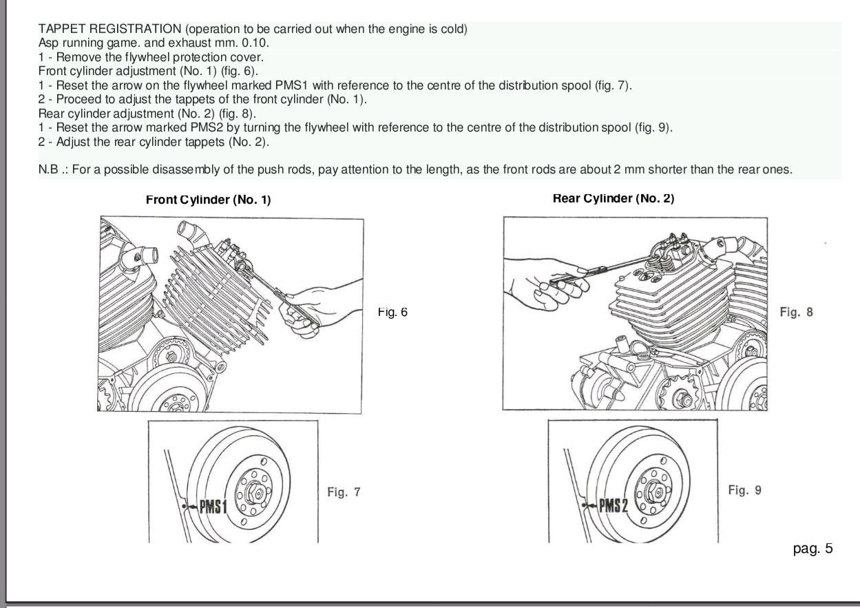

I have the engine in the frame and have removed the side covers. The previous owner said he has gone through the engine ( changed the cambelt) and as the speedo has 10,000 miles registered does look really good. I thought it best to backtrack the process of rebuild. But turning the engine over the PMS 1 and 2 marks have no relevance to the TDC when I put a screwdriver down the plug hole. I was on the thinking that this generator flywheel was on a key way and can only go on one way? The PMS marks should be aligned with the camshaft nut at TDC?
The engine turns over with no binding.

I believe if you have the original alternator then the pms mark is next to the sprocket, photo below. I have a transalation of the owners handbook for the 2c if you pm a contact I can send you a copy
