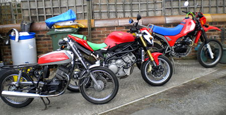

It was sunny this morning so I got them out and played with them, here is a photo.
Perhaps it should stay Red? Perhaps Green, Ninja Green or maybe red and silver.

- morini family.jpg (167.62 KiB) Viewed 39997 times
