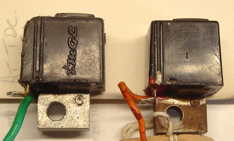

First image clearly shows a dab of white between the two parallel lines moulded into the outer side of the trigger coil on my original coil, on the right of the image. The replacement coil, on the left of the image, whilst not having a dab of white paint, does have the two parallel moulded lines in the outer side of the body. The centre of these parallel lines measures the same distance from the leading edge of the two soft iron poles, protruding from the top of the moulding.

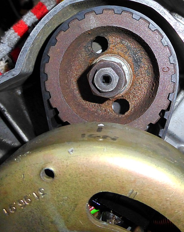

Second image shows that when the two marks on the outer side of the window on the rotor, can align with the two parallel lines on the trigger coil casing. At this position the "ANT" mark on the periphery of the rotor does align with the centreline of the camshaft.

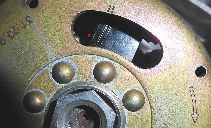

Third image shows (tries to) the alignment of all the marks and flywheel details.
If your German expert is saying that the PISTON 'TDC' mark, rather than the IGNITION 'ANT' mark, should be aligning with the centre of the camshaft, when the parallel marks on the rotor and trigger coil align, we have a problem!

So, see attached images:.... just wanted to know if your pickup has a white line on it at any point, mine was replaced so cannot say, but he says the white line has to line up with marks on the rotor at TDC.

- Original trigger coil on right. Replacement on left.
Parallel moulded timing marks in casing. - pick-up_comparison.JPG (112.05 KiB) Viewed 21798 times
- Parallel lines on rotor and trigger coil.
- rotor_marks_align_pick-up2.JPG (166.66 KiB) Viewed 21798 times
- Timing marks alignment on rotor, camshaft centreline and parallel lines on trigger coil.
- rotor_timing_ign.JPG (173.06 KiB) Viewed 21798 times

It looks to me from your photographs that I may well have the wrong pick up fitted it does not have the mouldings which are in effect used to set the static timing (if we do not have a strobe) the advance and retard is adjusted by the stator plate in the slots to set the 'previous' setting.
