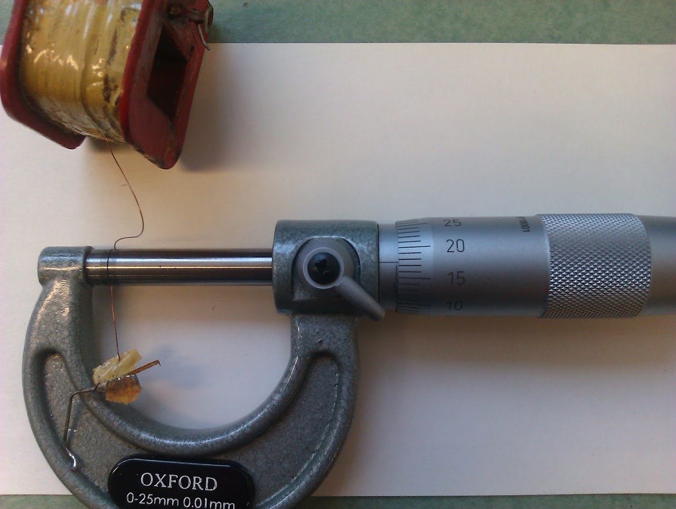

I do wish this 300 ohm misinformation would go away.
That may be what is written in the 'blue book' and it may well have been true at the time of writing, but it's a physical imossibility for the overwhelming majority of coils (I have come across a small number of factory 300 ohm coils).
The resistance is a function of the number of turns and the resistance of the wire per turn. The resistance of the wire is in turn a function of its diameter.
I've measured the wire diameter on nearly all coils as 0.15mm (overall diamater is a little larger because of the insulation) as shown in this picture;
With wire of this diameter, there simply isn't room on the bobbin to wind enough turns to get to 300 ohm. 300 ohm coils do exist, but they use thinner wire and I suspect were more prone to breaking down, which is why the thicker wire was used.
The resistance doesn't matter very much, just the voltage ouput (within reason).
If you KNOW that a coil was wound as a 300 ohm coil, but it now measures 220 ohm, then you know it has shorted turns and is failing.
If that coil was wound as a 220, then it's proably just fine, but many a good coil has been condemned and needlessly rowound (sometimes badly) just because it read the 'wrong' resistance. People have often used thinner wire just to be able to achive the 'correct' 300 ohm value.
When I rewind a coil, I don't bother counting turns, I just use calipers to meaure the size of the coil. That will usually get me to withing +/- 4 ohm of the nominal 220. I will write that value on the coil insulation, so that in future, someone can see if the value has changed.
