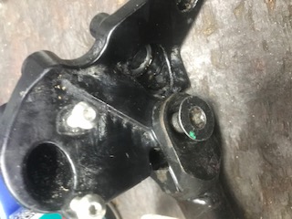

-Having looked at my second cast bracket just now, I can see one potential issue which may be related to your bolt undoing, and if not is certainly undesirable. Hopefully you can see in the attached pictures- The pivot bolt is threaded into the rear section of the side stand. As Nick says, it's not long enough to have a lock nut on the back. However it is also threaded all the way up, which means the threads run in the bronze bush which is in the side stand casting. My one actually has enough threads gauged into it to be able to quite securely screw the pivot bolt into the casting. Net result is that when done up, there would be threads engaged with both the side stand and the casting, so the rotation is going to be trying to undo one of them.
My suggestion is to check the bronze bush for damage and probably replace the bolt with a shoulder bolt so that the bush runs on the shoulder as opposed to the threads.

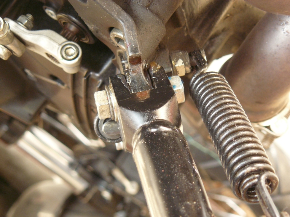

Now that I've managed to reattach the sidestand springs, using a steel cable loop around a long wooden lever pivoting on the end of the sidestand ( :roll: ), I've found that having a through-bolt with locknut has potential problems. As the stand is pulled down, the springs swing past the clevis, such that they are going to brush the nyloc nut. Hopefully not enough to hurt, but I may have to resort to a slimmer nut and loctite.

I did need to shorten the through-bolt I fitted, and resort to a plain locking nut with Loctite, so as to clear the springs.

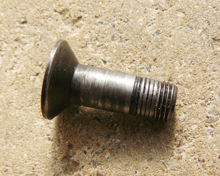

Here, I hope I can attach a pic of the old bolt, and you can see how much it had come undone by the bruising on the thread.
P1040160 Scrambler sidestand bolt smaller.jpg (375.72 KiB) Viewed 12256 times
P1040161 Scrambler old sidestand bolt small.jpg (264.21 KiB) Viewed 12256 times
