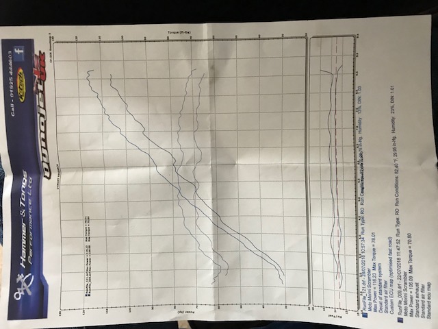

Well, much as I love my Scrambler, the fuelling was horrible, especially at low speed which, with loads of 20mph zones in my town, was not fun. So importer Amore Moto put me on to Hammer & Tongs Performance in Warrington.
Had a great discussion with Sam and we decided a decat and custom map was the way to go.
Just picked up the bike today an it is amazing, so smooth and responsive! I had to take the long way home and then went past home and carried on going. Even more of a joy to ride now.
A great side effect of fixing the tune is a decent increase in power and torque too! 106 to 116bhp and 70 to 78ftlb
Highly recommend this mod.

Shaun, well worth doing. It's a different bike now. Much more what I expected. It's not cheap but worth doing. I'm going to look into getting a custom exhaust made through Hammer & Tongs by Pipwerx. Sam at H&T says they may then do a tuning package and exhaust. I'll let you know.

Hi, all in it was £650. That included the decat and a Sam West doing the work on the Dyno tweaking the map. It was a custom map as there are no existing remaps created or supplied by MM. It may be cheaper now he has a map and you'd save a couple hundred if you decided not doing the decat
