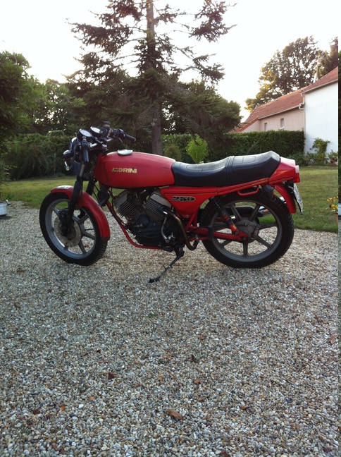

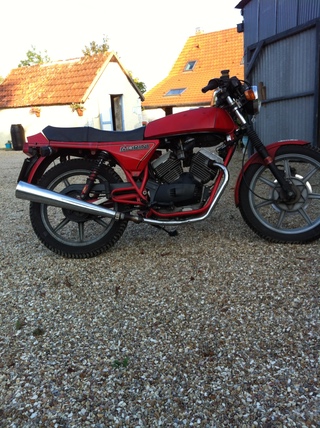

Well - look what just turned up!
Looks pretty complete with new tyres too, missing the key to the fuel tank though.

I've never seen a 250 with a 2:1 exhaust before (well still with a 250 engine). Home brew? Nice to see it has adjustable bars - though the position is a bit odd to my eye. Are they OEM ?

If it's a 'home-brew' the exhaust system looks pretty good. I think the bars are original - though in an upright position. The foot controls appear to have been cut in half and re-welded to be shorter ( :? ), the plastic instrument console has split (don't they all) and the fuel tank appears to leak along one seam :( , which is OK as I can't remove the cap to put more in (yet)!

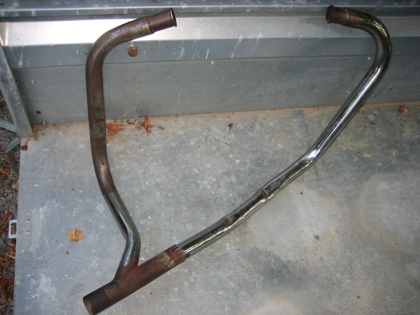

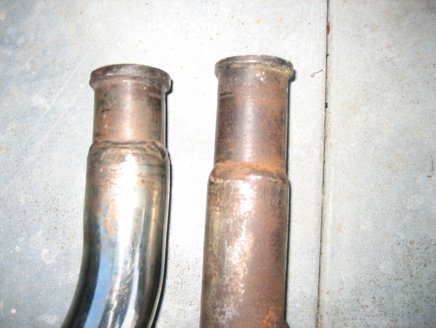

Took the silencer off, it looked to be in good condition from the chrome but when I turned it over it was rusted through at the back, then the baffles fell out in dozens of bits from the inlet! The 2 into 1 exhaust is definitely home brewed, the front pipe is in pretty good nick but has been bent upwards by a lump hammer, it has a short spigot before joining the chromed outer sleeve. The rear looks genuine, with a longer spigot to sleeve dimension and 'proper' looking curves under the bike to the integral Y piece.

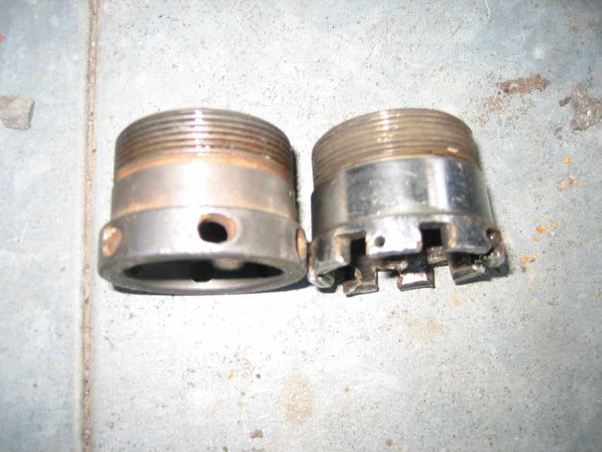

However, the front pot has a larger than standard exhaust nut, though not as big as a 500! Looks to be turned from mild steel, with circumferential holes for a peg spanner, rather than tessellations. It had 2 large copper washers instead of an exhaust gasket.

Front & rear pipes of differing spigot length
Ex spigots.jpg (147.93 KiB) Viewed 30055 times

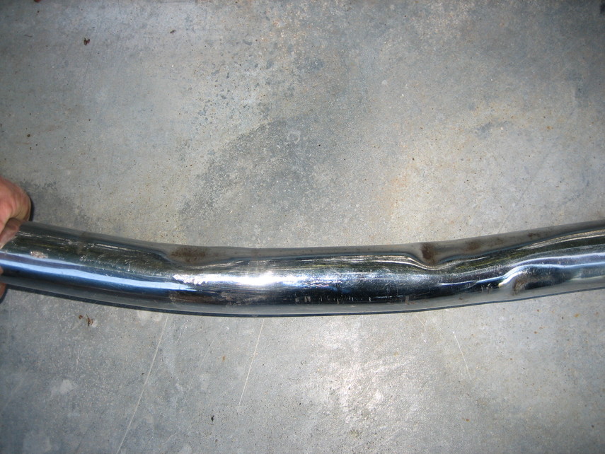

Well crafted pipe bends (?)
Pipe bends.jpg (171 KiB) Viewed 30055 times

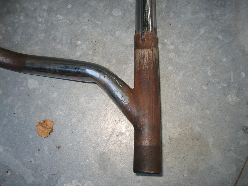

Y piece and rear pipe.
Y piece.jpg (153.01 KiB) Viewed 30051 times
Ex nut profiles
Ex nut profiles
Nust 2.jpg (146.49 KiB) Viewed 30051 times

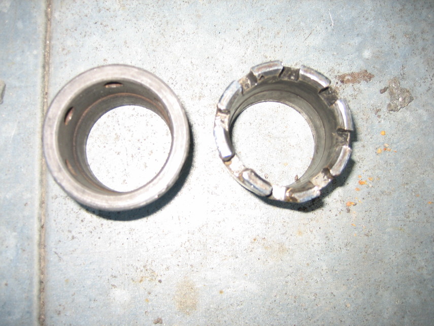

Ex nut outer ends
Ex nut outer ends
Nuts 3.jpg (158.84 KiB) Viewed 30051 times
Standard collets fit both nuts with no problem.

I think they tried to fir a 350/500 header set to the 250... the Neanderthal way
Posts: 1568
Re: 250C2
hendre wrote:I think they tried to fir a 350/500 header set to the 250... the Neanderthal way
You have to get a bit Neanderthal to fit a 350 system on a 350 engine a 250 frame. It doesn't quite line up properly ;)

It actually fits OK, just looks a bit 'moche' (ugly / unsightly in French)!
