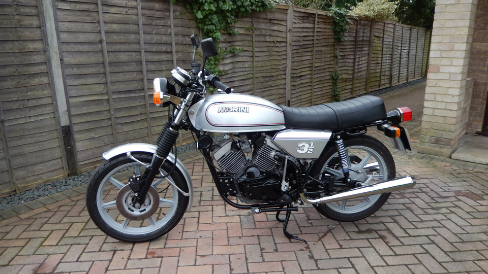

This is nearly finished, just waiting on the seat to be finished off by RK Leightons in Birmingham.

Wheels are powdercoated mercury silver & satin lacquered, the engine cases are black enemel & were done back in 1995.
Complete stainless steel exhaust & full carb. rebuild & seal. This bike will be featured on the Oil Smudges website at some point this year.

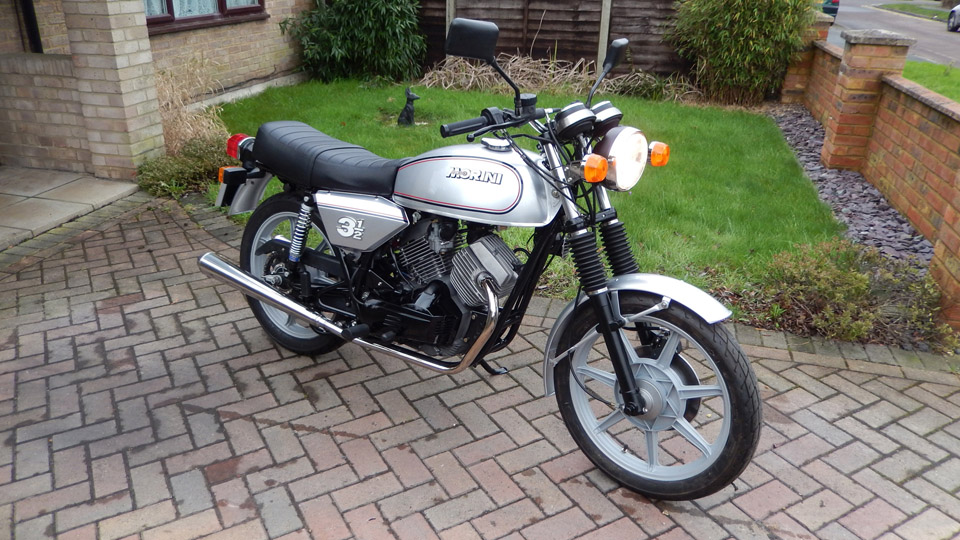

Finished pictures, starts first kick using only front choke. Need to get some miles on it now & take to shows.
