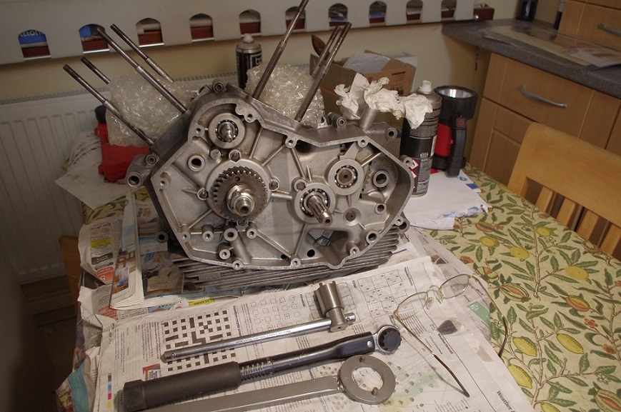

All new bearings fitted with ease (oven and freezer) in to the LH crankcase and the gear cluster (teeth, bushes, selectors and dogs all good enough for me) seems to have gone back in OK after finally correctly identifying the variant (Table 4A not 4 in the parts list I found and not as in the original Harglo blue book either). The one with a toothed washer/shim, that also helpfully bore witness to having been up against a seeger clip - so that clinched the position after I'd temporarily lost track of where it went. I found (after having been given a tip) that a large zip tie strategically wrapped round the cluster helped to keep things in place as I j-j-jiggled. Also that a particular sized, very sturdy, KTM/Husaberg original parts cardboard box made a perfect cradle to support the case on. Can't check end float or selection until the RH case comes back from the crank regrind and roller bearing job via NLM but I plan to do a 'dry but oily' run of those without the crank in first. Everything seems to spin round OK for now though. Presumably the correct end float relies on a centre gasket being fitted? This engine had none (nor the vital copper washers). The manual I'm using talks about applying a coat of silicon sealant to the mating faces - but surely this must be in addition to gasket 21.01.57?
Next job is to reassemble the oil pressure relief valve (as you can imagine, given the state of the inside of the cases as shown in the photo above, it needed a very thorough cleaning) and fit a new crank supply oil seal in to the clutch/side cover. I think I'll replace with a DPSM (ADP) type as that's what was in there and Barnwells can supply the 15247 size required.

More progress than in this photo today. Oil pump, primary drive and clutch cover now back on. I even managed to get the kickstart spring wound up correctly. Next stage is a quick check on clutch end float but I'll probably leave final clutch assembly until the bottom end is in place in the bike. Lighter to lift in to place without the top end on and I still remember the cunning dodge required to get a 350 rear cylinder and head on when in a 250 frame.Time to order pistons and start preparing the heads and valves. I hope I can find the pushrods from the cylinder that I pinched the head from for the 2C/375. Fingers crossed they are in a box in shed #2 along with the rocker gear.
I might have a preliminary investigation of the cam timing soon. I know I can't do it properly until the top end is back on, with the clearances set appropriately, but a bit of a trial run with a degree disc while watching/feeling the cam followers might be interesting as the cam is a bit of an unknown quantity.
The sparks department (including stator and rotor) on the project bike 250 can do for a first start attempt in due course. That starts amazingly easily, so the components must be in at least reasonable condition.
I think I'll temporarily borrow the PHBH 28s and intake rubbers from the 2C/375 to quickly know it lives again and it will have to make do with the 2C 2:2 exhaust system until I can tell if it shows enough promise to justify throwing even more cash at it.
