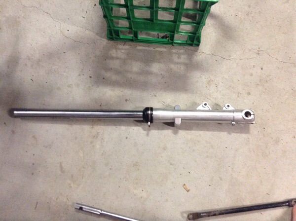

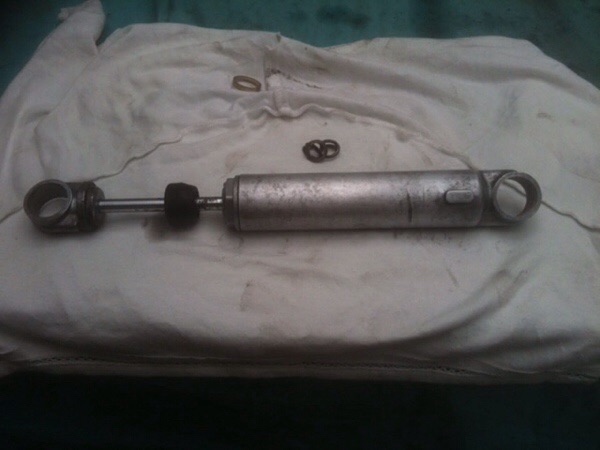

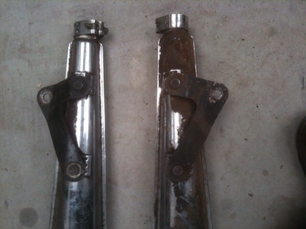

Got some new caps for shocks and seals for forks oh and dust cap new oil a bit of polishing and they were done.
Same treatment for shock rods
Fork tubes re hard chromed

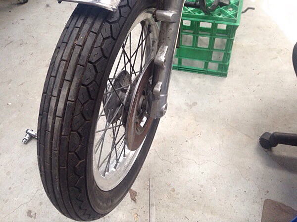

the rear wheel was out of true and spokes were starting to furr up so I decided to take them to a wheel builder for new spokes polish rims and hub clean. With the brake disk disided to leave alone it will clean up on the road

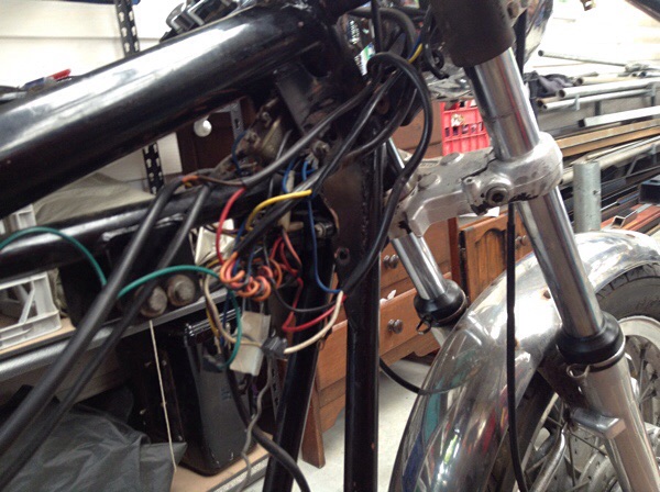

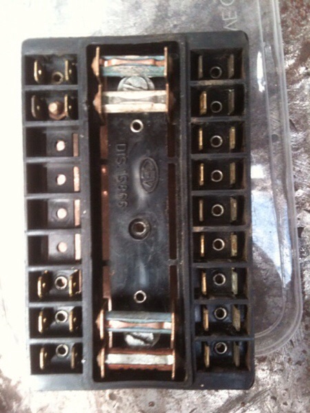

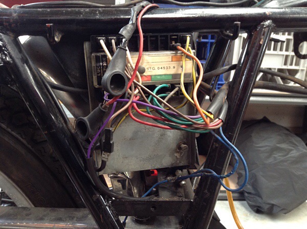

Now the bit I was dreading the wiring .haveing never done it before apart from the odd plug I started small with the switch gear. My one saving grace was I had something to copy I took my time and bought some good wire stripers and crimpers.

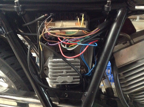

Silencers were prity rusty with holes in them down pipes also rusty might have been able to pach up but by the time I got them re chromed would be the same price for new item
New wireing aftermarket reg/rec

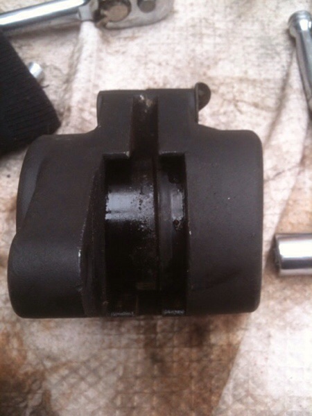

The brake master cylinder piston was shot and couldn't find parts so North lestershire motorbikes had brand new complete master cylinder . I was able to rebuild the caliper with new seals ect
