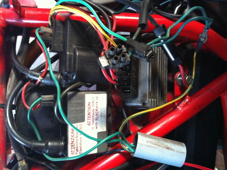

While hooking it up, I was wondering again about the weird extra 'thingy' this Spanish 2C came with in the ignition system. About the size of a large flasher relay. One yellow/green connection (to the stator green wire). Two green to the transducers and an earth lead. It seems to be some kind of complicated way to split the AC feed from the stator to the transducers. I know at least one other 2C owner has found a similar device on a 'late' 250. I've left it in place so far when using the OEM setup and will keep it zip tied to the frame in case I have to revert, as it does seem to spark pretty well with it in the circuit.

Here's what you are talking about - spaghetti junction...
Sorry, photo is rotated, so 'the thing' is down the bottom. It doesn't show on the MRC wiring diagram, the only other I have is in the Owner's manual, but is very blurred and not conclusive. My 250 is still a work in progress, winter having intervened, along with a load of other jobs to do around the house.
That's it. I wired the project up so that it could be eliminated from the system easily but I've never yet got round to running it 'thing free'(if it works...). I hooked up the module yesterday by attaching just one of the green wires from it and it ran OK. After I've rigged up the module and coils mountings, I'll try it hooked up direct to the stator green wire and see if I can notice any difference.

I can't remember what I said last time, but my guess is that it's either a voltage limiter, or an interference supressor.
The copper plate on the ignition winding is supposed to magnetically saturate the stator Iron and limit the voltage, but the Germans prefer to leave it off and use an electronic limiter (similar to a Zenner regulator).
It doesn't look factory, becuase the connector boots are not the original style. Perhaps it was a market specific fittment to comply with local inteference regs.

EVguru wrote:I can't remember what I said last time, but my guess is that it's either a voltage limiter, or an interference supressor.
That would be my guess as both machines were originally sold in Spain.
