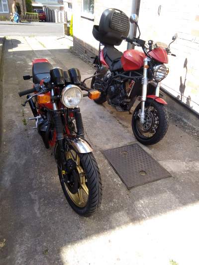

Beautiful! Mine probably looked like that back in 1983. Do you know the colour-code or name of the gold on the wheels?

Re: Winter 2018Rebuild
<FOUND> - lower post in this group got me directed to Soren's
very helpful website & it is RAL 1036.
I am also interested in the color code (paint or powder)
for the wheels. the bronze gold or gold . . . . . .

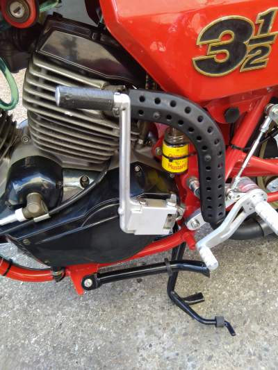

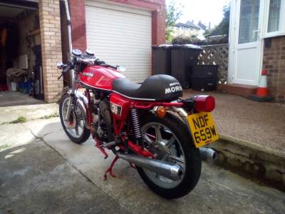

Maiden voyage today...

Looking good then. That mustard bottle, is it to catch mayonnaise from the breather? Surely you need a Hellman's jar?

Looking good, but MOT? Whats that? Your bike looks 1978ish? so shouldn't need one. DVLA form V112 applies, along with the free road tax.

Steve,
Just trying out something to catch any oil, as it goes over the disc otherwise, with slippery consequences. At the moment it is cutting the mustard...
Geroge, the bike is 1982/3 so needs an MoT. Now to do battlewith the DVLA...

Received a V5 from DVLA on Tuesday! New number plate fitted today.
Job done! Just in time for Winter.
Thank you RedVee...
