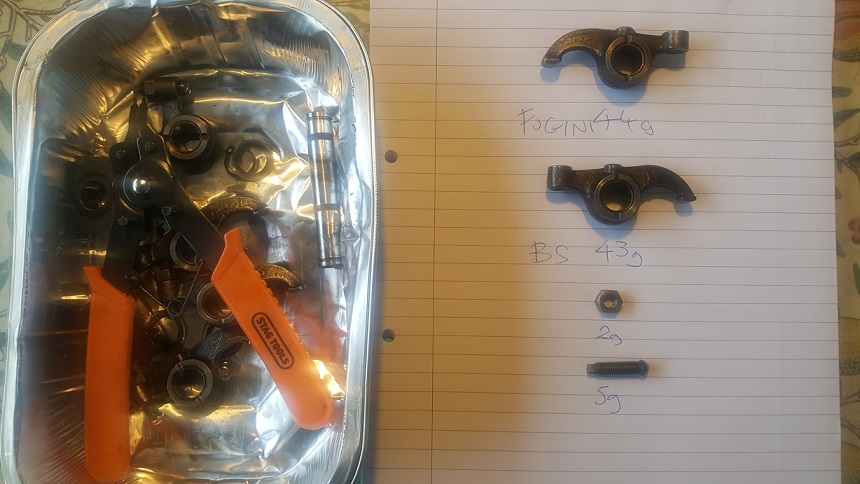

Did some preliminary weighing of rocker arms out of interest in case I do attempt some lightening. First observation is that there must have been two OEM? makers: 'Fugini' and 'BS'. Interestingly a sample of four Fugini and two BS arms reveals that the weight without adjuster can vary by 1g or so (as best as my not very accurate scales can tell). Also one of the Fugini arms has a significantly 'shallower' height at the adjuster end - yet is one of the slightly heavier items.
The spindle on this set seems a tiny bit worn but M'Dina only have used ones available and whilst I was able to sort through Rob's box of used rockers that's not so easy with bits 'on-line'. Not too bad though and I can see if either of the two spares I have somewhere is better.
