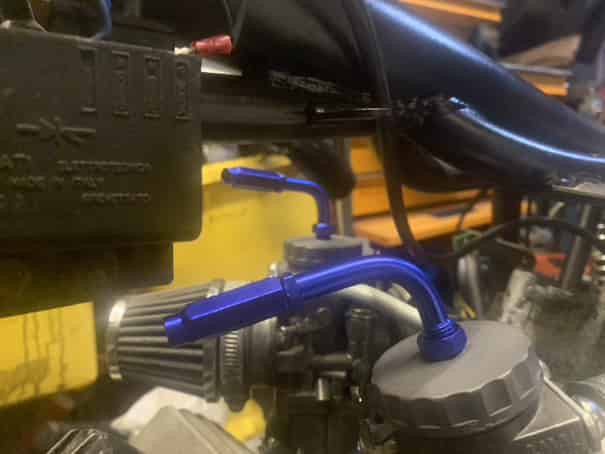

Next is the throttle cable set up on the Amals. I didn’t like the top-in run through the top cap kinking the cable so I’ve cast a pair of blanks & fitted the blue angled guides. I couldn’t see one that was made especially for Amal MK2s off the shelf. I’ve now made new cables to suit & it works a treat. No notchy pull & smooth return. Drops to a full close & it can reach full bore. I should be able to start it now.

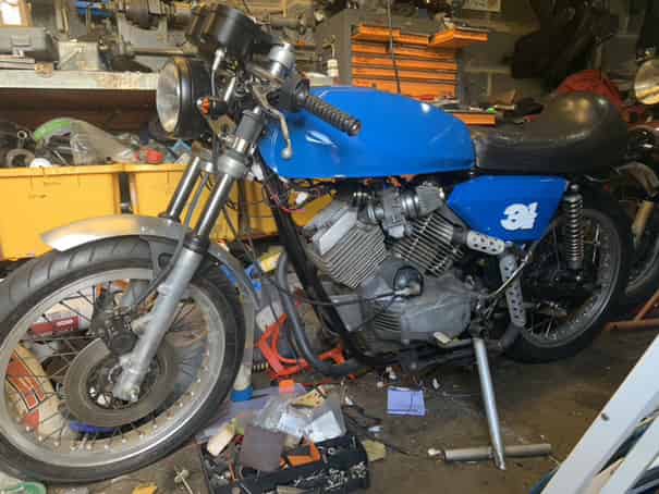

Latest update : it runs. It has fully working electrics (home designed/made loom) & starts easily. I wish I could send video as it sounds, ‘well’ with an open 2 into 1. It has a registration. It is road ready bar the unfinished paint job so I haven’t got the taps on. There are a few details I’d like to tidy still but I could take it out on the road right now if I really wanted to.
I’m having a go at making a nice rubber clutch actuation arm cover and specific 29mm to 24mm inlet stubs for the big Amal carbs, that are properly flowed. They’re an ‘iterative’ process to achieve but I consider them do-able, though the stubs as a casting are going to be very tricky.
