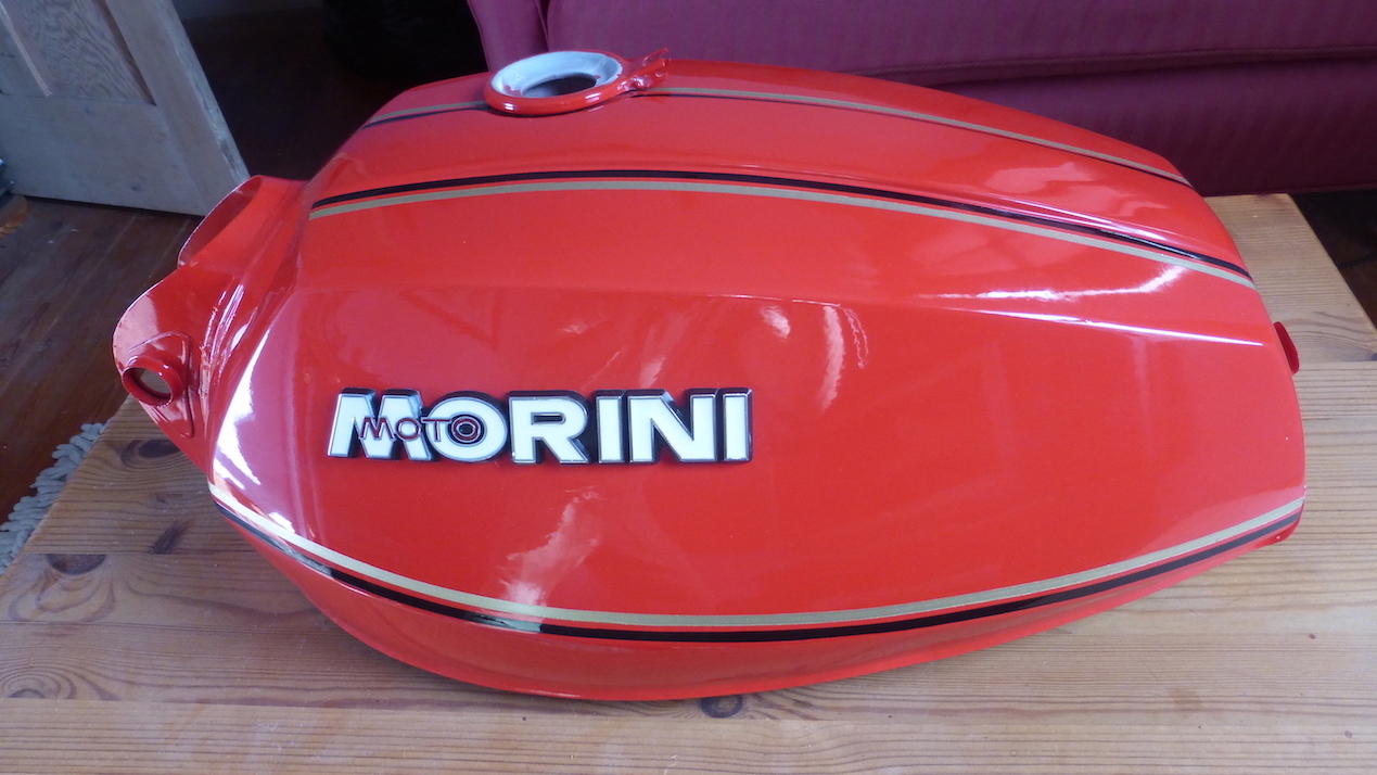

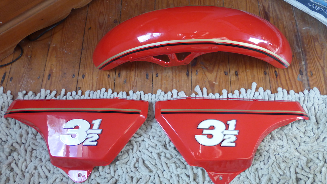

Managed to finish most of the tin work today and fit the badges. Anyone had any black chroming done on exhausts, if so roughly what sort of price ?
- P1030248.JPG (419.17 KiB) Viewed 19443 times
- P1030249.JPG (458.55 KiB) Viewed 19443 times
Re: rough 3 1/2
Wow, looking good !

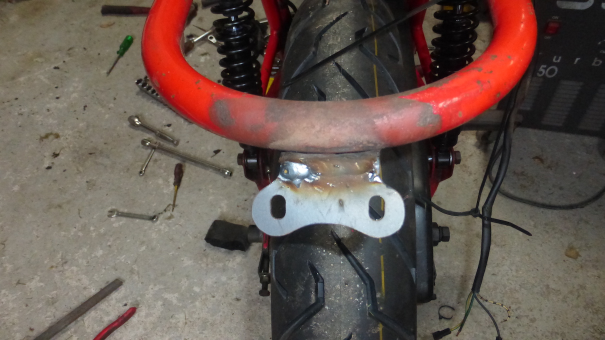

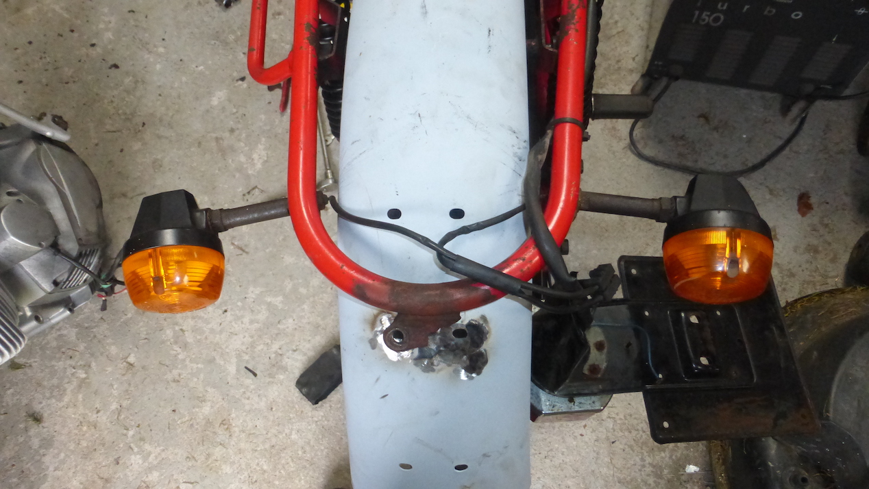

Had to do a little fabrication for the rear mudguard bracket. Is this a common point of failure ?
- P1030346.JPG (405.12 KiB) Viewed 19244 times
- P1030340.JPG (458.52 KiB) Viewed 19244 times
- George 350
- Posts: 567
- Joined: 16 Jun 2007 09:43
Re: rough 3 1/2
Haven't seen that before, but both my bikes have had one of the indicator brackets break up. Worth checking yours while you have the welding kit out.

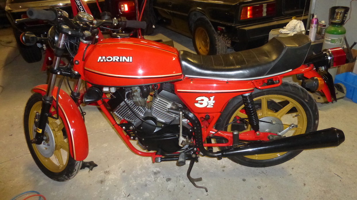

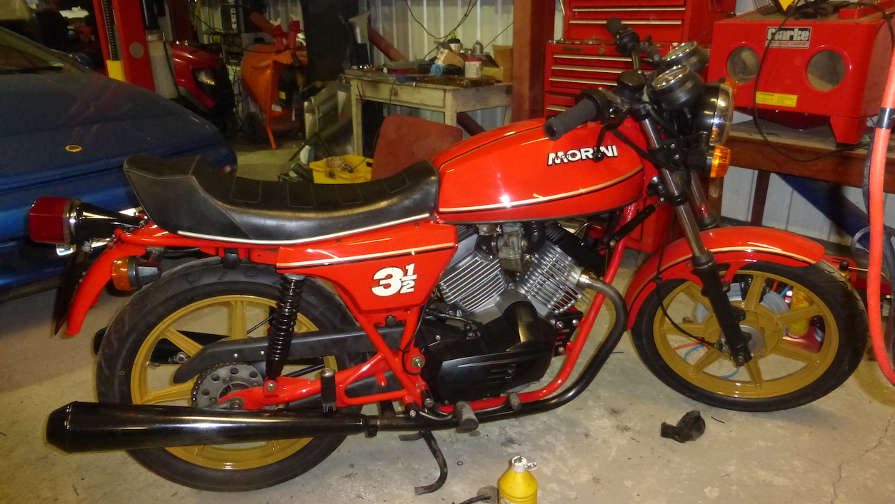

Finished for now. The exhausts didn't scrub up to badly, so have decided to leave them for now. just have carbs to balance and centre stand to prep and paint. Had to remove the clutch so I could remove and paint the left engine case. after making a spring nut removal tool from an old chisel, realised they would not move. However, got out my lead welding set and warmed each nut up individually and found them all to come off with ease. Hope this is of help to someone.
- P1030399.JPG (491.68 KiB) Viewed 19168 times
- P1030398.JPG (485.7 KiB) Viewed 19168 times
Re: rough 3 1/2
That's Looking really good. Compared to how it was when you got it - you have come a long way!
- Posts: 1096
- Joined: 05 May 2006 13:47
Re: rough 3 1/2
Looking very nice. And some very handsome stablemates lurking in the background too
