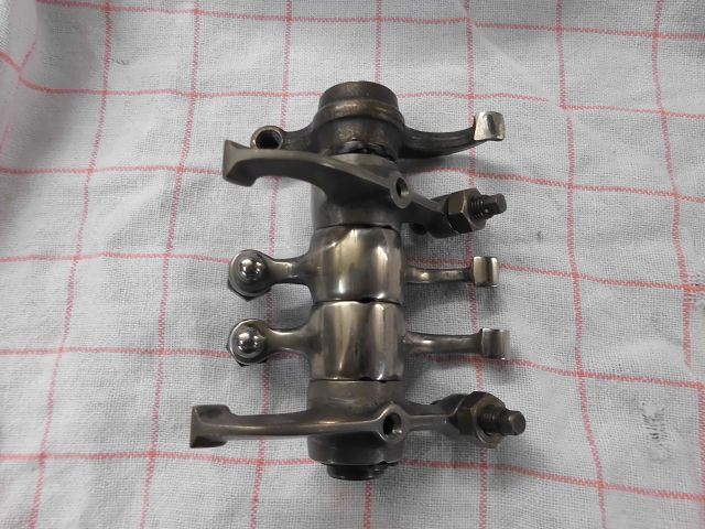

Posts: 935
Re: Forgotten Era Speed Hill Climb 350 Morini MKII

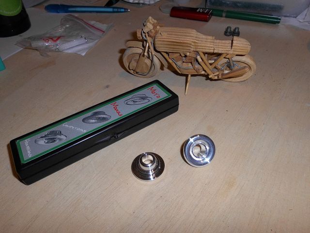

This rockers were reduced stayin on the safe size (hope so, 10 000 km without problem till now) from 40 to 38 gr. I guess you can take of more, but I`m not racing :wink:
It´s quite a lot of work for 2 gr. I saved much more with this valve spring retainers, each one 4 gr., that´s a 70% less than the originals. A friend of the Hamburg Meetup made them years ago.
But all that doesn´t help much, the motor is far from working how he should and could, allthough doing a 5000km spain trip this year :roll: :lol:
cheers

I already have light valve caps (WeeVee specials from back in the Benji Straw days). I shall be using those. Thanks for the photo. I also have Phil Irving's drawings on page 145 of "Tuming for Speed" to inspire me, but to be fair Lambertini made a pretty good job of the original design.
