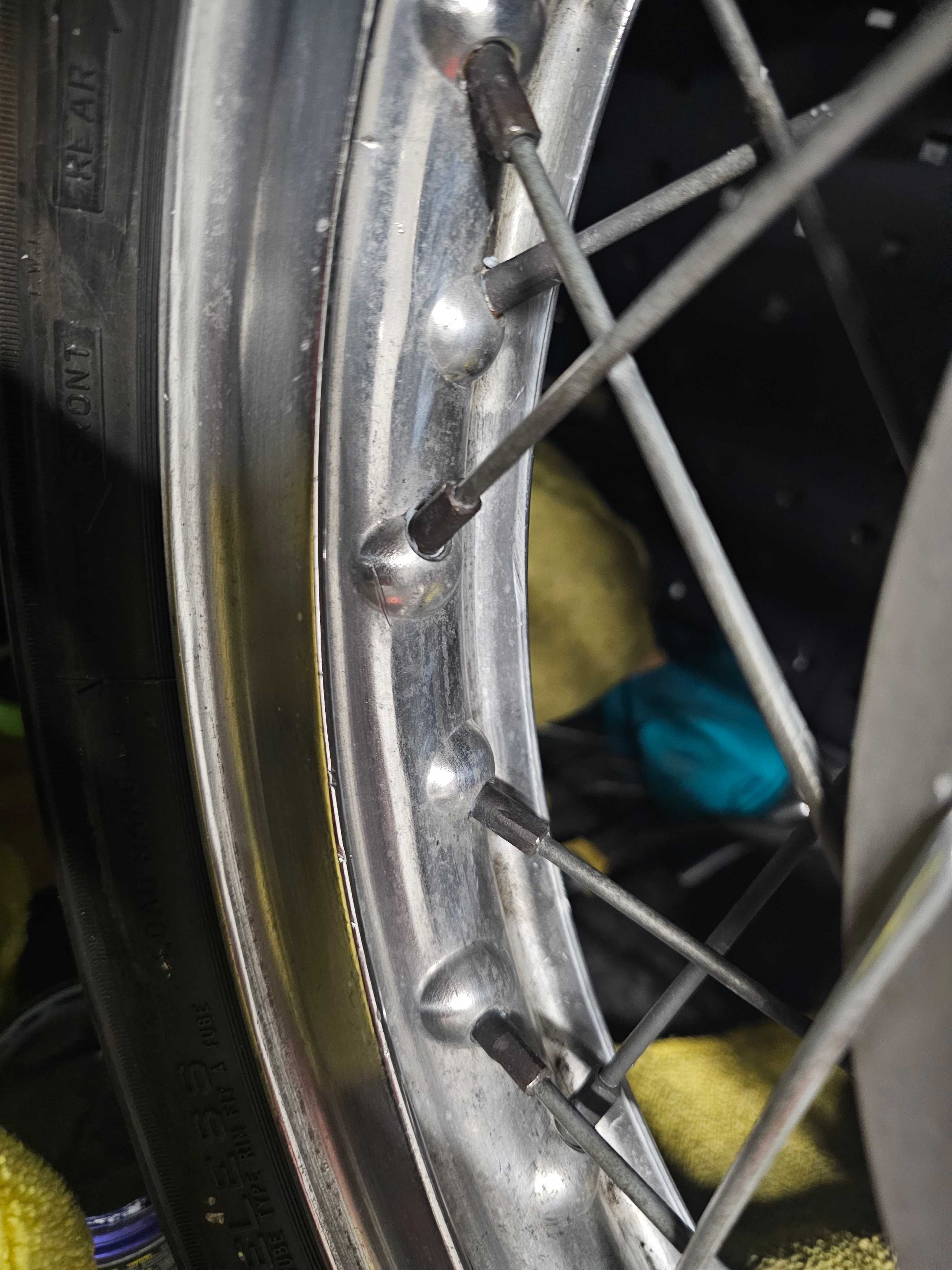

Cheers bud, it's pretty easy you can grab some microfibre buffing wheels for your drill off Amazon, then i went first with some Meguiars NXT and finished with some Mothers Mag and Aluminium.

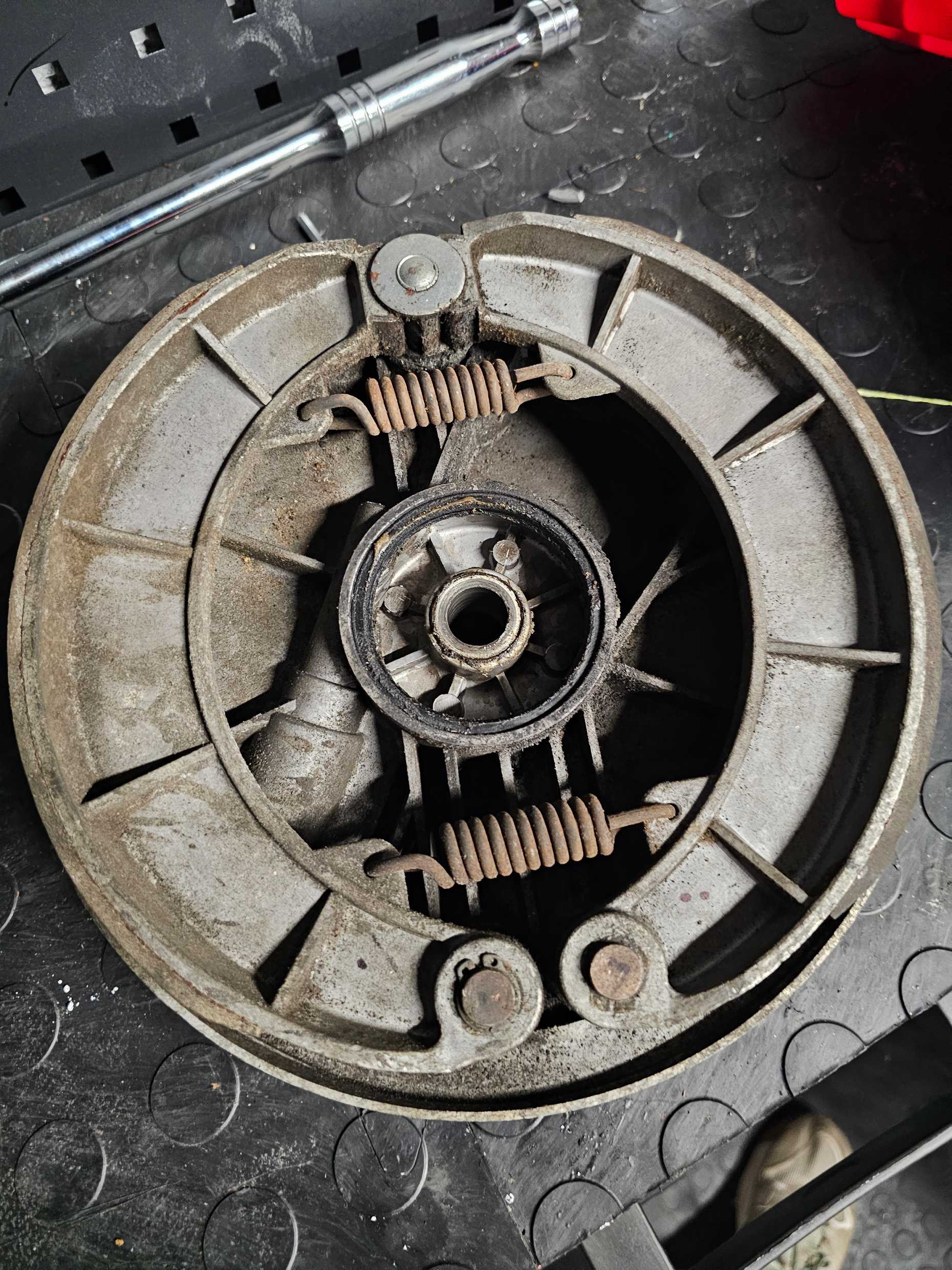

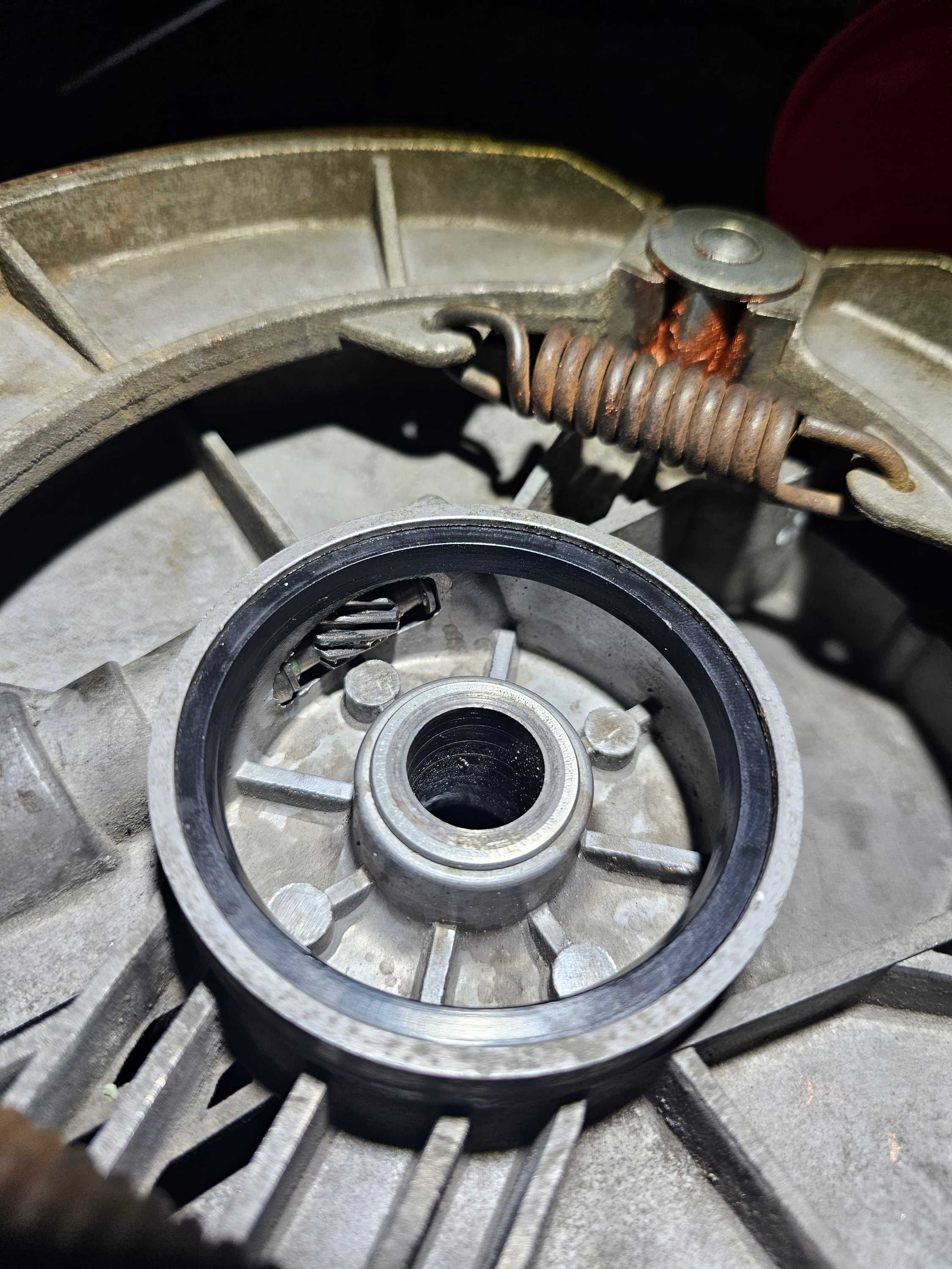

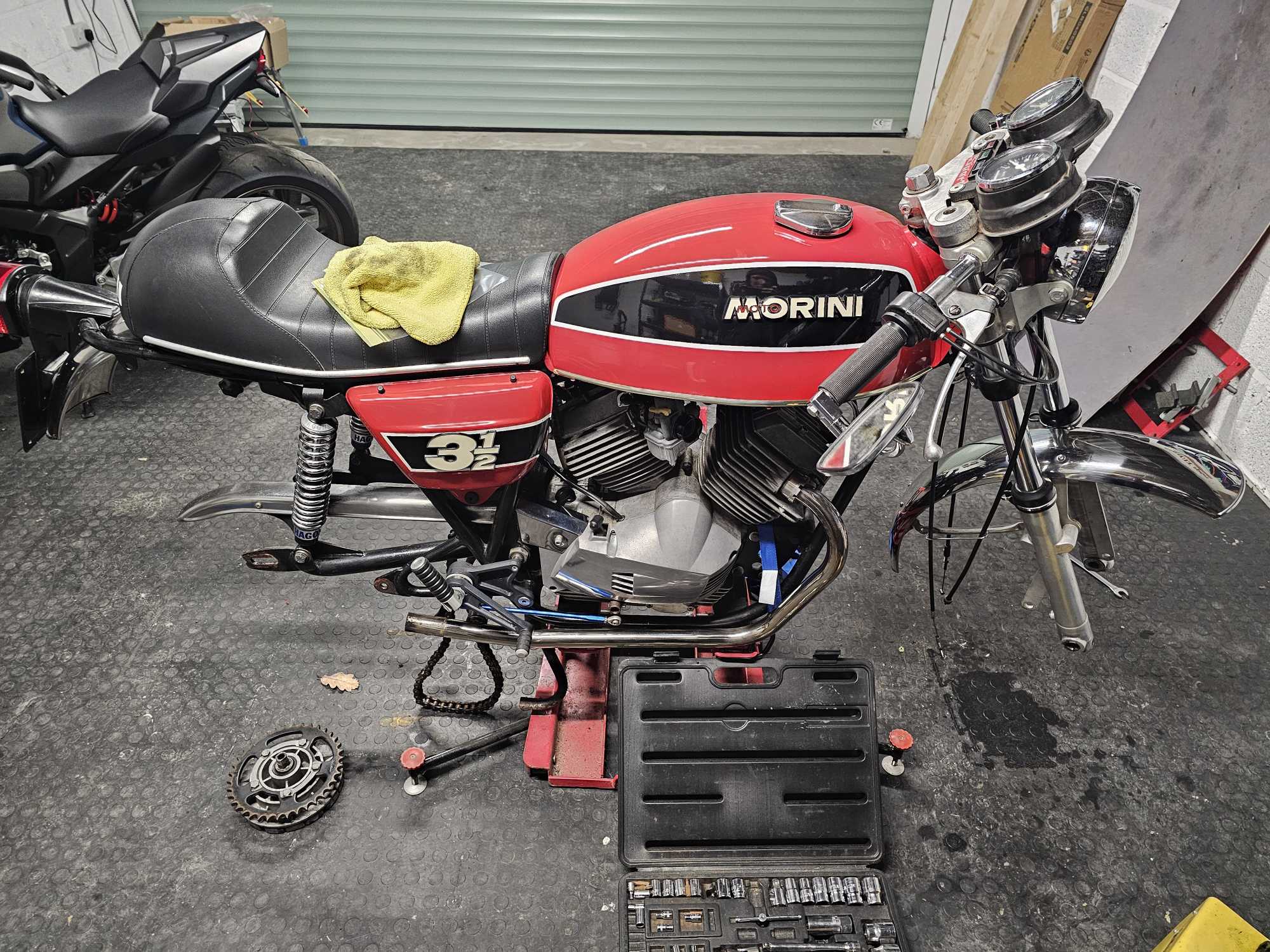

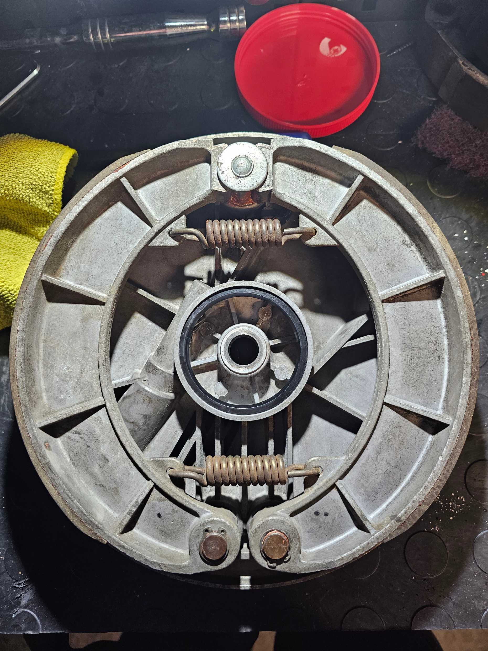

Annoyingly i have been bitting and batting at the bike as i was working over Christmas.
I've whipped off the front and rear wheels as the brakes were stuck on, was a bit of a farse as the brake shaft was seized in the housing.
So front is stripped, cleaned, lubed, rebuilt ready go in. Rear is next, its been interesting learning as i go especially the felt seal in the rear hub.
I have starting polishing the wheels before i put the drums back in, i am very tempted to fully strip them down as the wire nuts are rusty and its taking a long time to get in there and polish round.

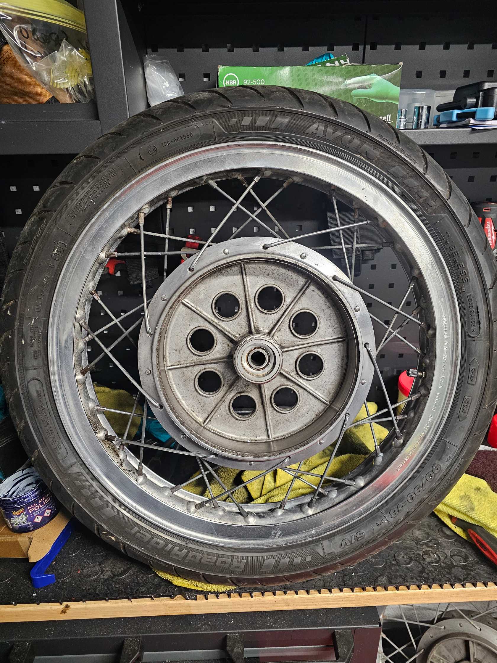

Unfinished not polished wheel
