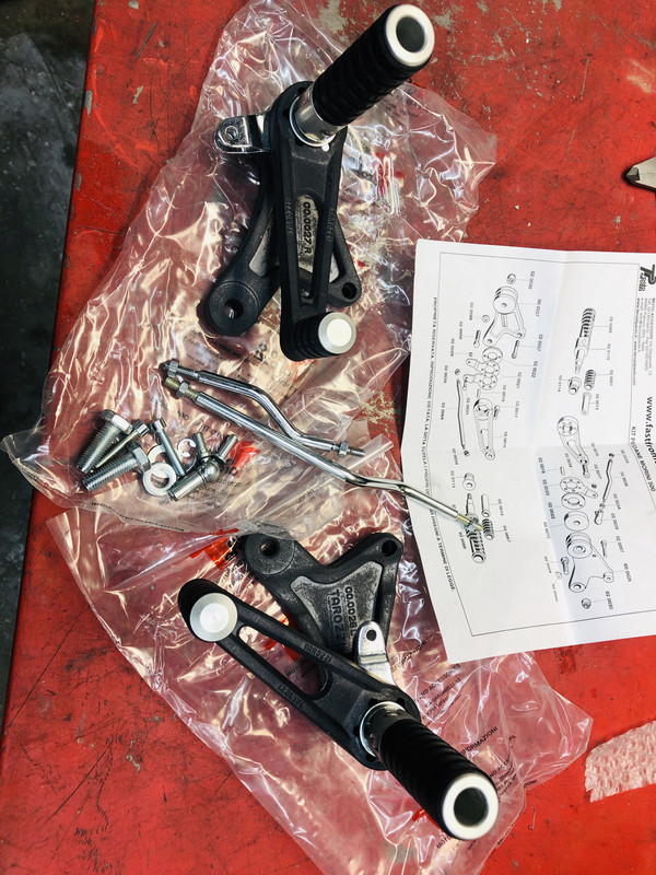

I bought a new set of Tarozzi rear sets from an American supplier. The kit include the left and right foot peg and lever assemblies and the control rods, four fasteners but only one of the required clevis connections. The parts included matched the parts diagram so if one were to consider this kit you will need three more connectors, I had extra heim joints so I used those.

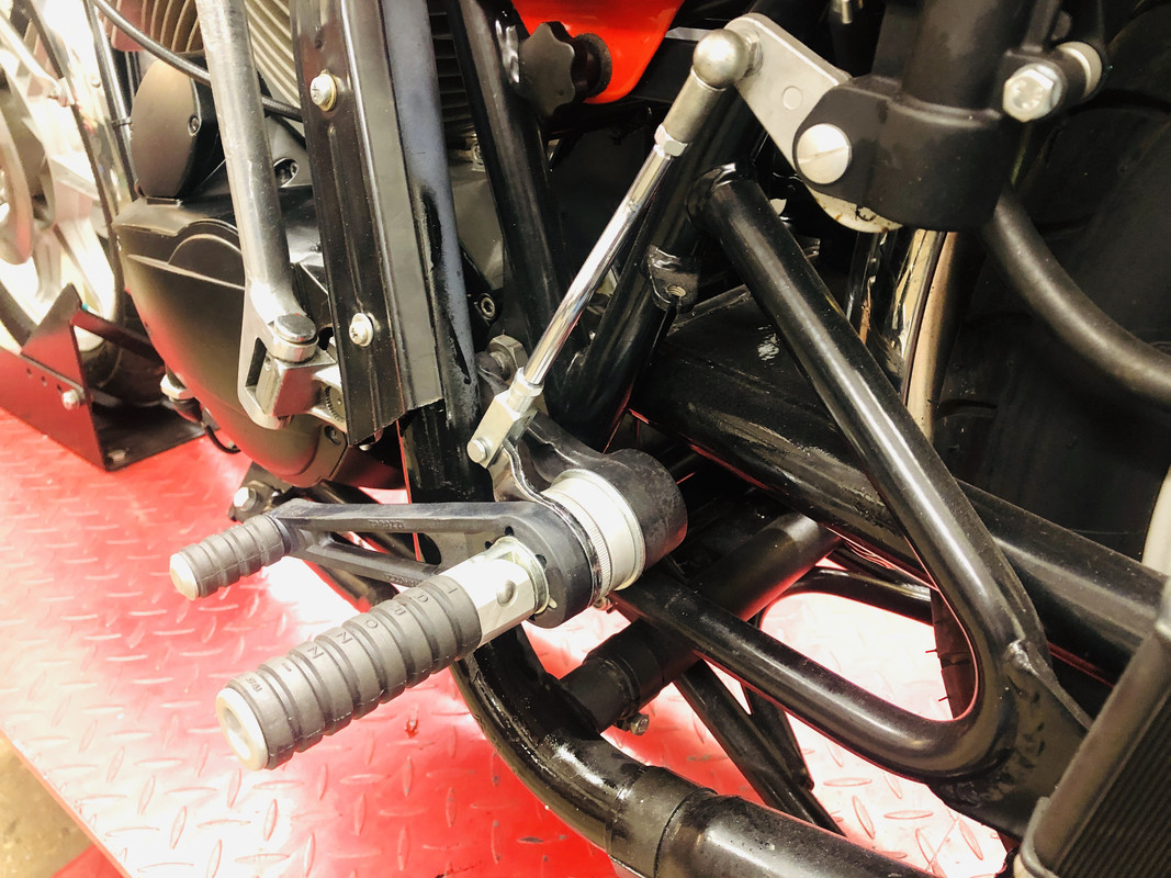

Installing the right hand foot rest / shift lever was straight forward, the right side does not use the original foot rest lug and the 6mm hex bolt is too long at 36mm, a 31 mm bolt is required.
I needed to fit a spacer between the upper mount and the frame, a 6mm (1/4") is required (not included), a stack of washers would do if you can't source a spacer

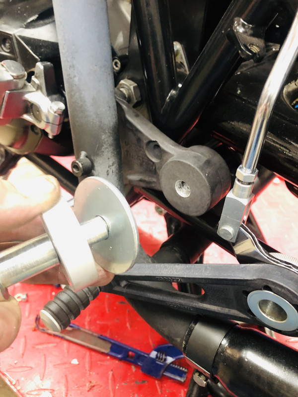

The left hand side was not so simple, a couple of problems, first the brake pedal will foul on the header, especially the lower heat shield captive nut.
I cut the nut off the header and I added a spacer between the lower rear set bolt and the frame, this moved the bracket out 2mm so the brake lever will not rub on the header.
I also cut off the bottom of the heat shield, re-welded the captive nut higher on the header, and drilled a new hole in the shorter heat shield
The foot peg positions and lever actions are smooth and I am happy with that.
The negative is that the kick starter will foul on the brake lever, probably enough movement to just start the bike if one were lucky, good thing the starter motor has been overhauled!

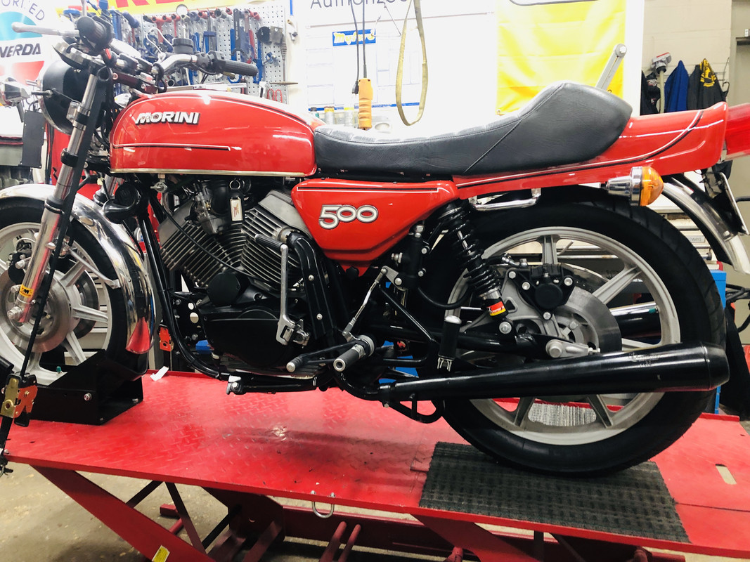

Overall I am happy with the kit, the previous owner had cut off the original control lever frame lugs and fitted home made rear sets that were awkward and resulted in a upside down shift pattern, this new set up is a big improvement.
I hope this can help others make an informed decision on rear sets.

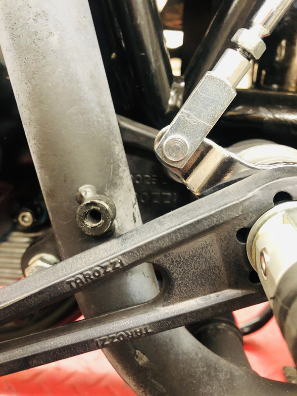

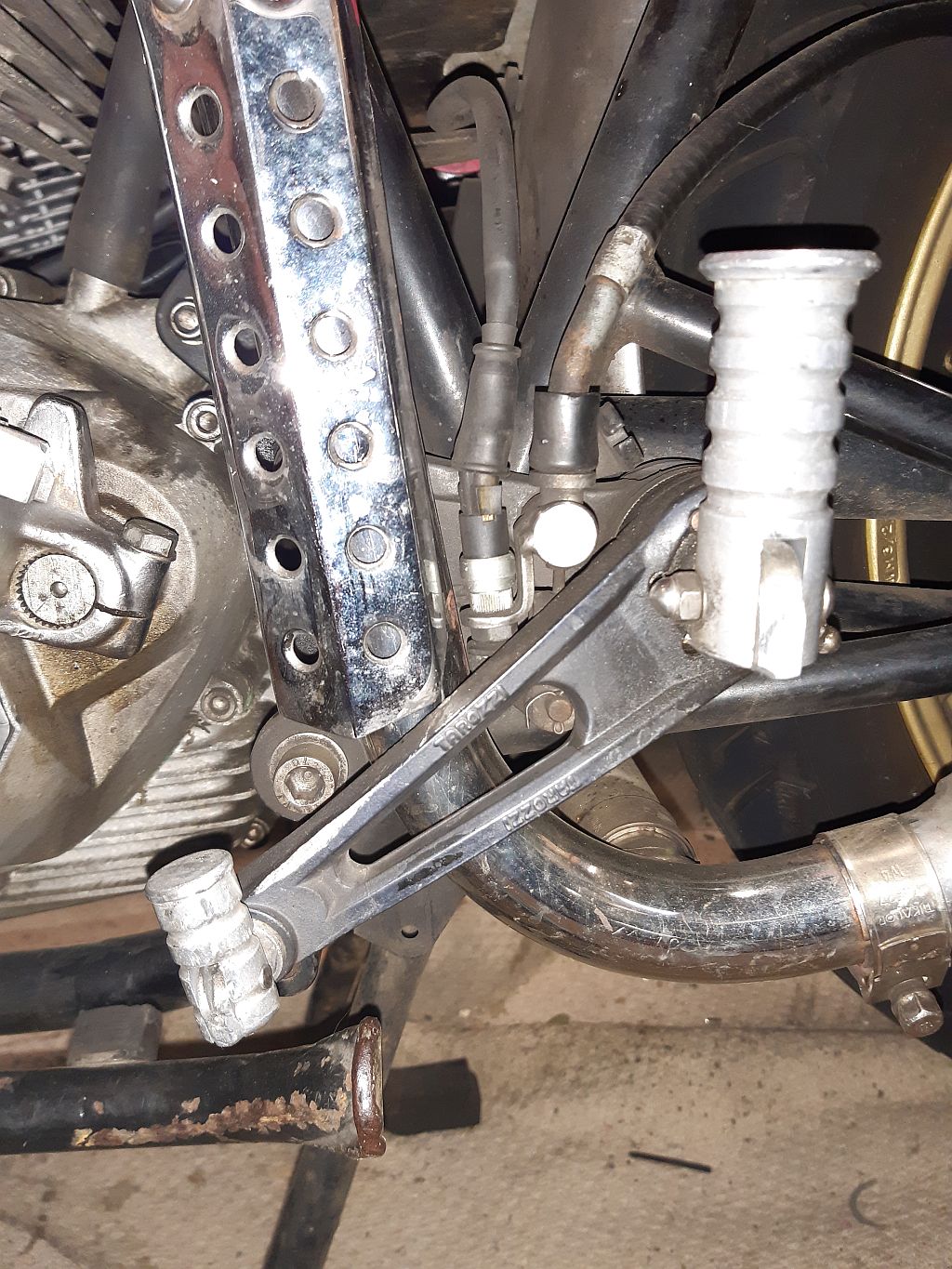

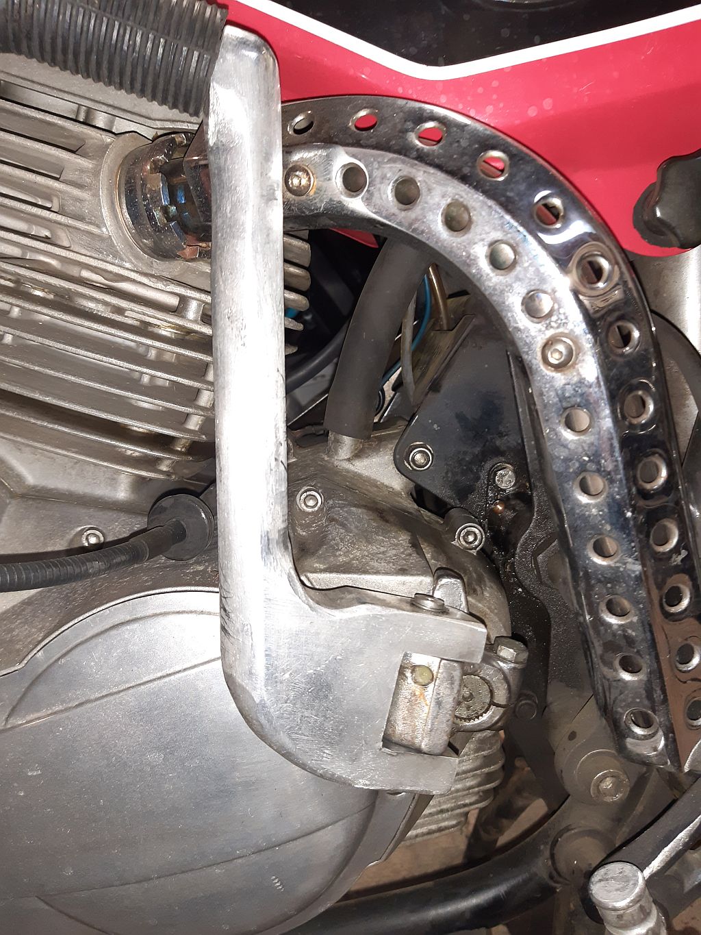

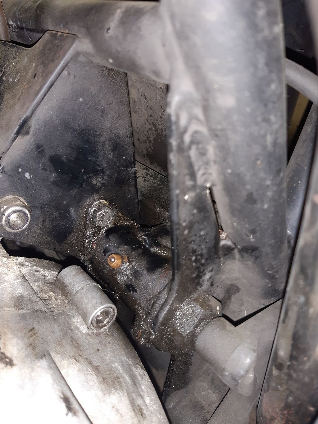

Glad you sorted out the fitting issues. The only 'non fit' issue I recall from fitting mine was that the rear brake cable needed modifying (not an issue for disc rear brakes maybe). A modification I also did which is worth doing is to drill the swinging arm on the left bearing and install a grease nipple on the top of the pivot as the original location is now used to mount the footrest back plate. It saves having to remove the exhaust to grease the bearing. On the right side I used an NLM supplied hollow bolt to hold the plate on with the grease nipple fitted to that.
I can confirm what Tom says - that the Tarozzi 'arms' are vey easily broken by the kickstart hiting the brake lever end. They are only die cast alloy. If your kickstart can contact the brake lever tip, it WILL break.
My solution was as pictured. I made my own fold up footrest and brake pedal end (Tarozzi now do these, but didn't when I needed them) and having gone through the 'NLM spacer' with standard kickstart which eventually broke, I made one to my own design from 30mm thick 'HE30' aluminium. The original lasted over 20 years until the complete kickstart assy went AWOL in Spain a few years ago. Mk2 (same pattern) now performing as per my first one. My bike is non E-start, so is essential it works ok.

Some Pics of LHS Mods

RHS Grease nipple mod

Is there any info on how the grease nipple fits into the spline shaft when the rearsets are fitted?
