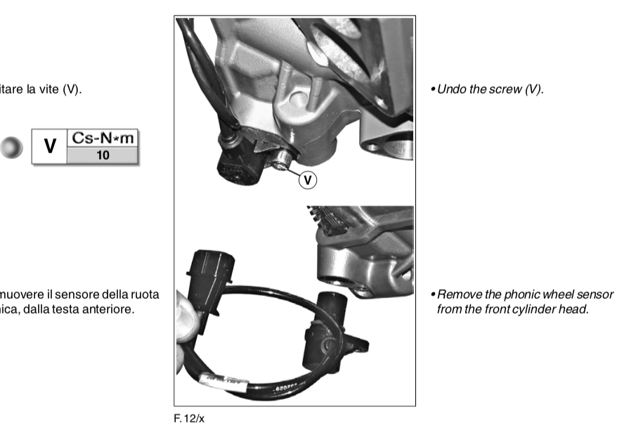

I dont know. Once i was riding and see battery sign on dashboard. Was chanched a rectifier . Charging is good.Check wire and contact connections. May be in bad condition. Need changing. I changed + red wire from + battery to 40 amp fuse box. What is crankshaft position sensor in Corsaro 1200? Or is it phonic wheel sensor on front up cylinder?
Re: Shots in engine.
Ok, my bike load only when rpm is high and battery icon is nearly all the time on dashboard when I start engine but it disappears when I drive.
I am not sure about crankshaft position sensor... do You have the manual ?

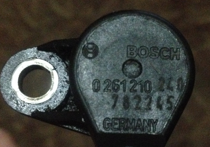

Hello. Happy new moto season! I decided to replace all that is possible. Changed the air sensor, which is under the panel. I want to replace the throtle position sensor. But I can not find Bosch 0261210240 with the same number. Or these sensors no longer produce, maybe others like it now. Who knows the analogue of this sensor? Article number 0261210240
BOSCH 0261210240
Cable length [mm] 445
Resistance [kΩ] 0.86
I bought a Chinese equivalent for now, but I want something more quality and reliable. I also did this. On the dashboard punched fuel pressure sensor.
