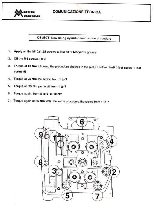

Hi has anyone done the headgasket on a Corsaro 1200 ?is the any info online torque and timing setting etc ?? Thanks Rob

https://www.dropbox.com/s/bh117v3a3xy2e ... l-1200.pdf
This worked for me can not get it to link tho

The factory changed the order in which you should torque down the head bolts. I don't have the update in electronic form, just a paper copy. Give me a day or two, I'll dig it out and scan it.

Thanks Guys I now have a manual The gasket did not look damaged I think I need to crack test th heads Thanks again
