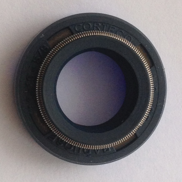

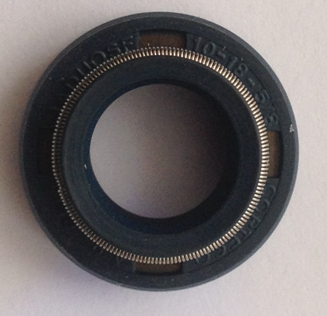

Re: Water pump oil seal
10-18-5/8 CORTECO A9 CFw BADUOSF
Its on seal body.
may be it will fit?
http://www.braapmotors.lv/s/params/cate ... em/267469/
Its on seal body.
may be it will fit?

Thank you gents. A great help. As ever.
