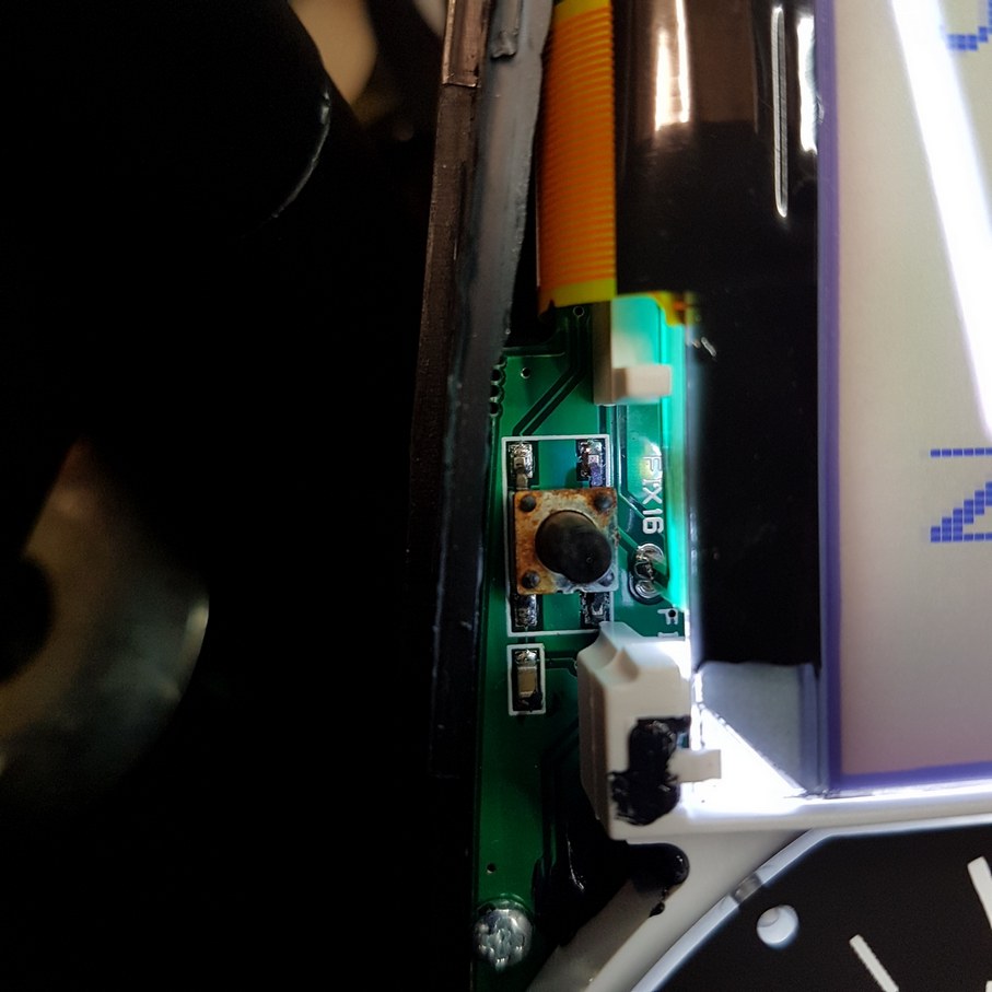

Next step was to look at the Tact switch itself. In normal operation when you operate it, you can hear and feel a distinctive click. When they fail, you cant hear of feel anything. Mine was clicking, but was mostly doing nothing, sometimes it worked, but mostly it would not.
What I did notice was some rust on the top of the switch. I figured that this was either moisture getting to it because the rubber pip was dislodged, or the pip had a hole in it, and moisture was running through it, down the length if the plastic body, and onto the metal top.
As the switch sounded like it should work, I decided to try to clean it with a proper electrical cleaning fluid.

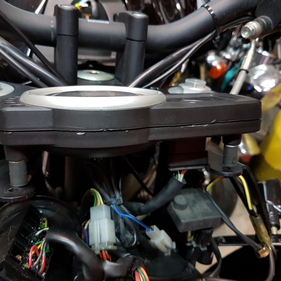

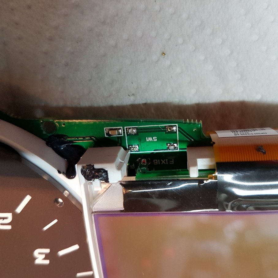

I have finally managed to resize some photos to show what I done. Some are the same as the other pictures in the thread, so bear with me.
This pic shows the clock cases separated. You can see the back silicon sealant which holds both half's together.
This pic shows the rusty tact switch. The rubber pip seemed to be intact, so I think the water was going around the edge.
This pic is what it looks like when the switch is removed.

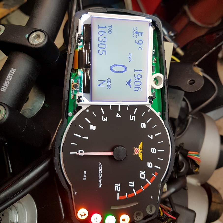

Finally with the clock cases back together. I have used some more sealant on them, but you can see the damage that can occur when you are trying to separate the two half's.
This was before I cleaned up the plastic 'swalf'
