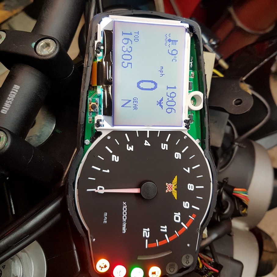

friction and silicone in my case.... here are some pics:

Placed so-called anti-terror (waterproof) switch on the left side of ignition cover
I have two buttons since i also have another dash mounted - in case the speed sensor fails (again)

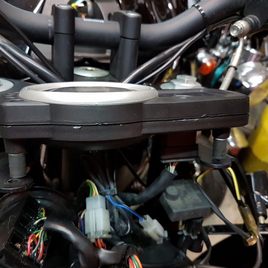

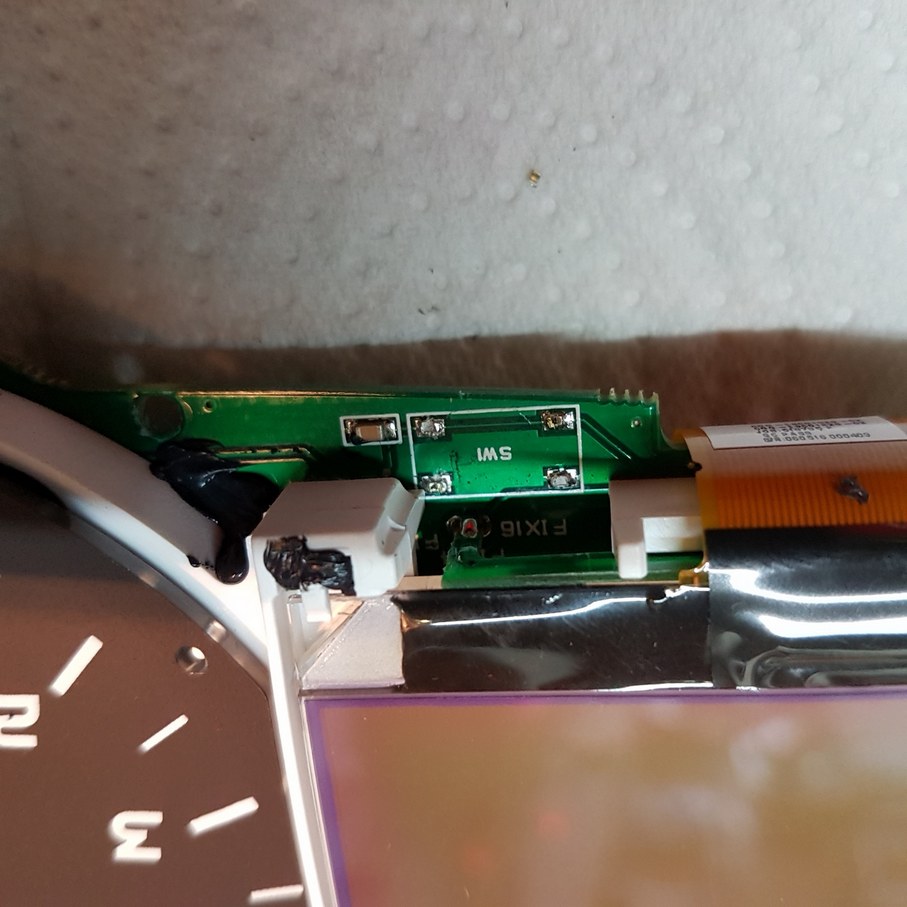

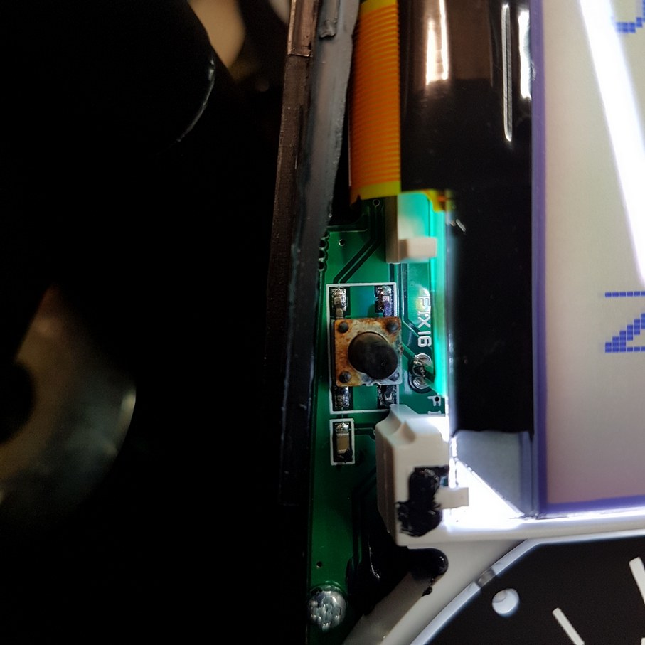

I have finally managed to resize some photos to show what I done. Some are the same as the other pictures in the thread, so bear with me.
This pic shows the clock cases separated. You can see the back silicon sealant which holds both half's together.
This pic shows the rusty tact switch. The rubber pip seemed to be intact, so I think the water was going around the edge.
This pic is what it looks like when the switch is removed.
