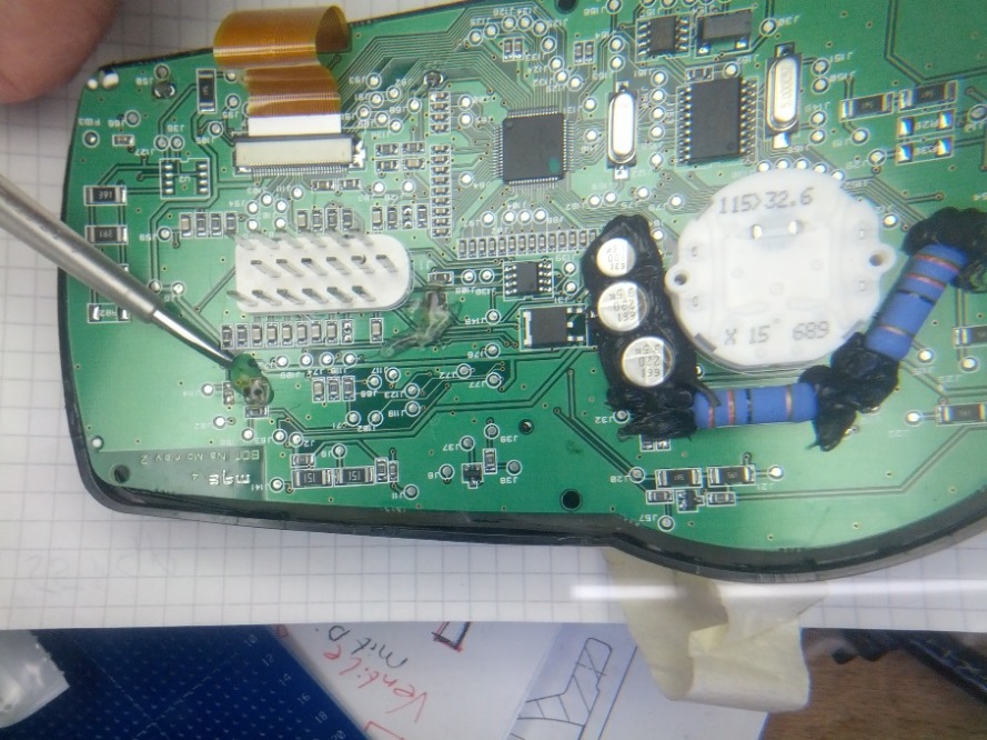

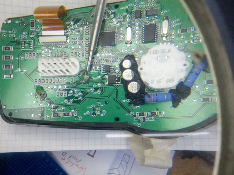

hi chips,Chips1953 wrote:The problem is the main beam and the dipped beam don't operate. They do if I activate the relays manually.
if the lights don`t work, you also could try to repair the dashboard by yourself. mostly the following transistors (shown on the foto) are the reason for "dark lights"

Re: Need some thoughts over this one. Well Done NLM!
Hi Gunni
Have you done this yourself? Perhaps you could setup a repair facility for the Corsaro etc.
Well that's cool. I have the capability but not the transistors. What are they, please.if the lights don`t work, you also could try to repair the dashboard by yourself. mostly the following transistors (shown on the foto) are the reason for "dark lights"
