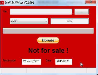

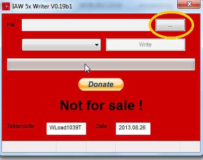

don`t worry, the process is quite simple. here are some screenshots of one flash-process, maybe it helps
start the writer
choose a map

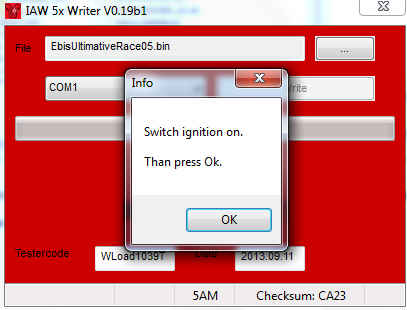

Re: Ducatidiag (JpDiag) great news, and questions
Posted: 16 Oct 2013 18:29
by günni

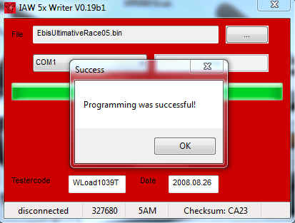

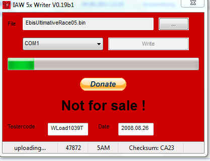

switch on ignition
flash-process is starting
process successfull completed

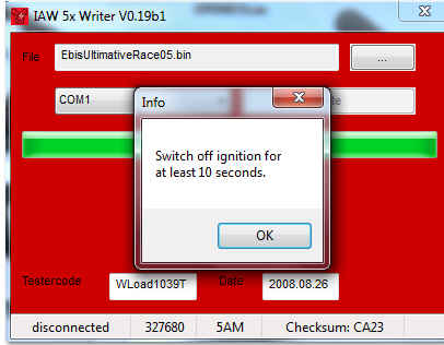

Posted: 16 Oct 2013 18:36
by günni
last of all, switch of the ignition for 10 seconds
that`s all!
