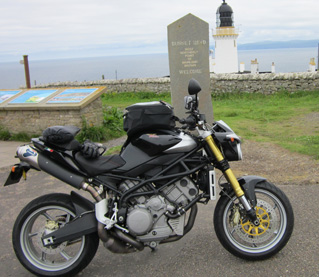

I am so disappointed that you have had this experience with the Corsaro. I can't help with the repair of the bike as I don't know what may have caused your problem.
What I do know is that for me the Corsaro is the best bike I have ever owned. On Tuesday I went to John O' Groats, form Carlisle and on Wednesday rode back in a downpour nearly all the way, without the bike missing a beat. 900 miles.
If you have the time, inclination and cash try to get the bike fixed and I'm sure you will be rewarded with hours of real joy and adventure.
Good Luck.
I got a copy of the manual from Twisty, if it's still available then perhaps he can let you have a download of it.

Hi George;
Sunny Dijon to damp John O'Goats; that Corsaro is seeing some miles (or kilometres...) then. Written up anything for ATG, it'd make good reading? :)
Rich;
Hope that it inspires you to persevere with the Corsaro! I've got a copy of the workshop manual on disc - send a pm and we'll see if we can't get together; at least you can hear how another Corsaro should sound then...
