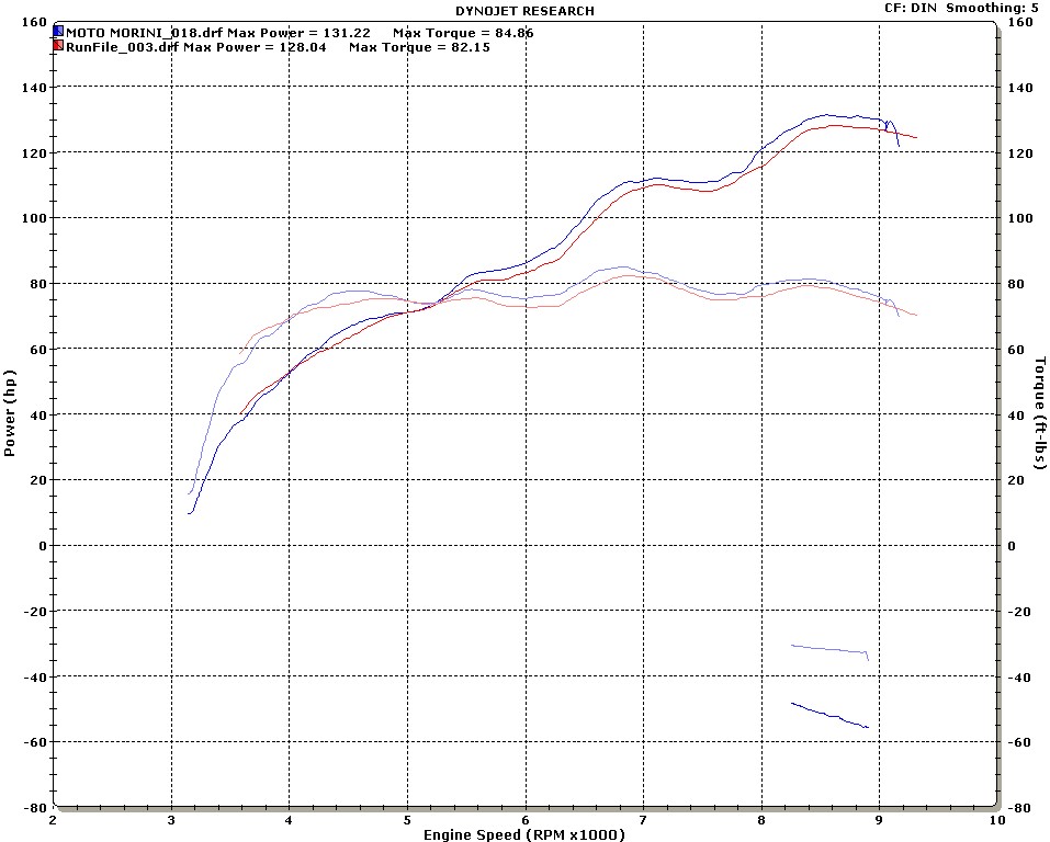

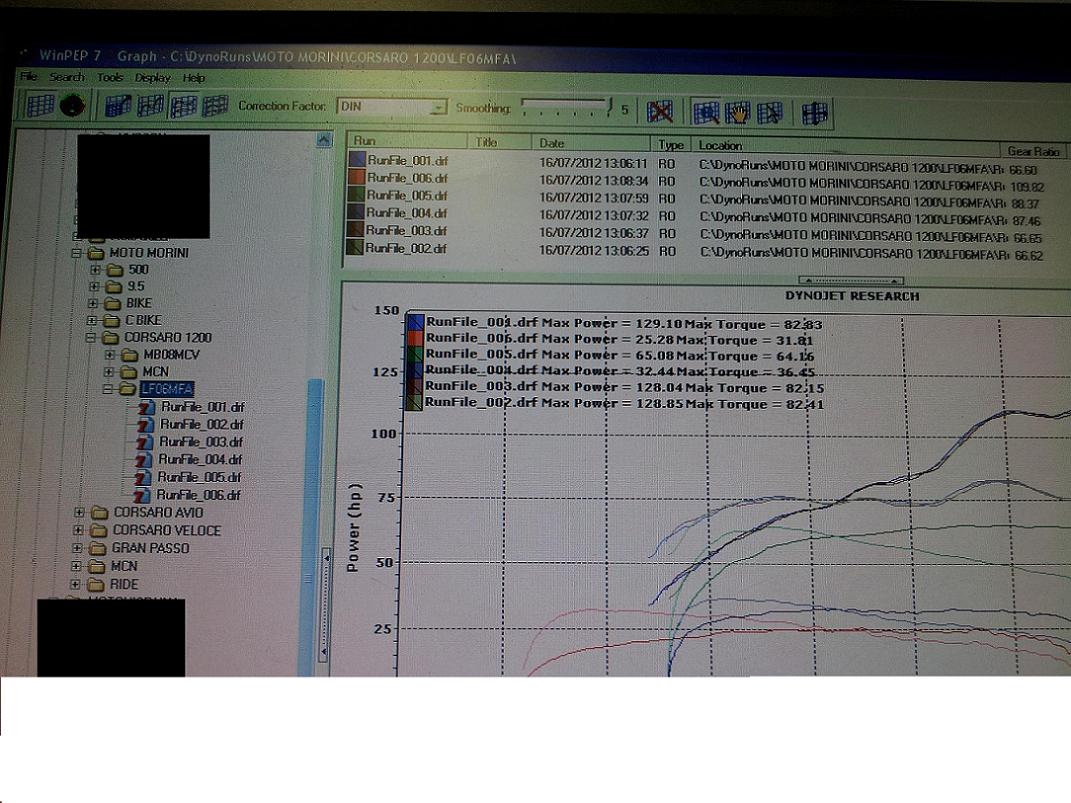

The processes

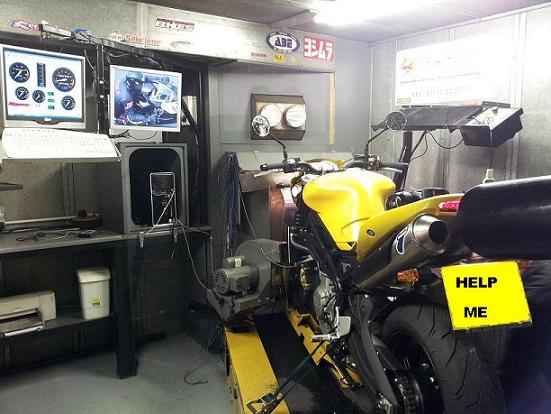

BSD Racing put the bike on a dyno, warm it up and see what’s what before doing anything.
First Dyno Run
In an 8-10ft square room the bike sits on a dyno all very technical.
The bike makes 129BHP at the rear wheel and 82lbft of torque. Everything vibrates including my organs. I loved every minute of it. I have pictures’ and videos of this I will upload them when I can. Video not the best as I did not want to stand to close and ended up trying to get a good angle putting my phone next to a wall and guessing where it pointed. The cat glows at one point. Mark of BSD comments after wards that at tick over it is over fuelling loads.
My base map gets over laid with changes from their specialist software, small adjustments are made then downloaded again to my ECU its then run once more.
After 9 runs it sounds totally different (Im not allowed in during this bit) im sat in reception reading tons of bike mag’s. Even in the closed off Dyno room, you can not hold a conversation in reception, She’s loud alright. The noise is very different a real roar and silky smooth with it. Mark comments after he is removing ignition advance too to improve the smoothness of the power delivery.
I really hope to get in again tomorrow; he starts at 6am though too early fro me. Next it will be started from cold and Mark will test ride it.

Post by Tricky »
UPDATED POST
Right the results........
Remember im not chasing BHP (yet) just want it running better after ballsing it up fitting sports cans. It is a great bike in any case.

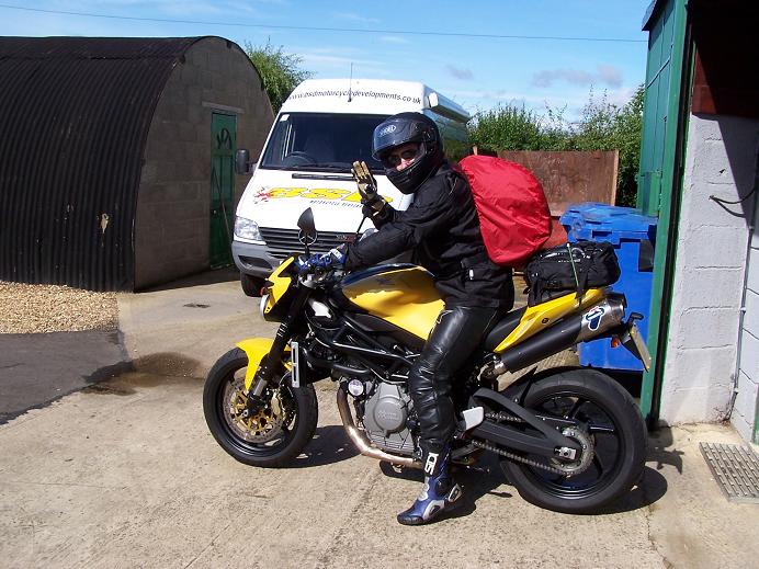

I got there before 9 am my bike was waiting out side. All done says Mark grinning like a cheshire cat! Cmon Mark I say whats it like, just ride it he says, whats the BHP I ask, he replies its on the USB stick. I say I may well decat my pipe, he says bring it back if you do, Mark says its not tuned to make more power, more to correct my issues. Im happy with that.
The bikes cold I saddle up ready for my 3-4hr ride home.
From cold its clear it needs to warm up, which is normal. It warms up quicker.
Jerkyness has gone,
power delivery is less harsh it does'nt feel so fearce.
I notice it revs very freely much more then before, easily getting near the red line with out me even looking at the Rev gauge, before it felt like i was over reving it after 5000 RPM. Now it will hit the limit, before I think the same as I once did, (NOT THAT I HAVE).
So much smoother, It didnt vibrate much anyway, now it vibrates less, less tingle in my feet at motorway speeds. Which is great for many reasons.
Less fuel used, I sit at 65-80 with occasional blasts over taking. The big engine feals like its happier, but how in gods name you pin that throttle holding it there in 6th I dont know.
Did not cut out at all. Increasing my confidence in Traffic.
The acceleration is bordering on too much for me. I nearly flip at one point at the lights near home,( ive been in the saddle too long with a detour in all 5 hours, I was very tired, heavy ruck sack on my back and gave it too much right hand) I pottered through the traffic, to the lights, a car accelerates very quickley leaving me in a vunerable position making it, unsafe for me so I open it up, up comes the front off the throttle back brake control and its down again! Im getting beyond my limits on this thing. Any big bike needs respect. I remember Adrian of 3X his words ringing in my ears its got twice as much torq as my 955i he told me. Im thinking of doing some sort of advanced riding course. It is a very powerful machine and needs to be respected.
Trully amazing bike im very happy. Tuning it for performancce and BHP, in my view its not for me at this time, it does not need more horses or torque.
Conclusion, if you alter in some way the fueling or exhauts invest in some Dyno time.
