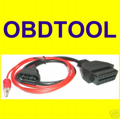

the link adapter cable to connect to the morini diagnostic cable ,about £12 uk delivered from germany. photo below (details in first link)
Adapter Stecker Fiat Lancia Alfa Romeo OBD OBD2 II plug.jpg (23.32 KiB) Viewed 25898 times
also reqd or similar (vw software not reqd)
available here for about £9 delivered uk (need to check if it is the same as this one is not for canbus)

anyone who is thinking of buying the cables, the FIAT OBD2 adapter comes in 2 versions....one with a single (+ive) battery connection and one with a double (+ive AND ground) connection. Having read through the forum this morning, both will work, but the one with the external ground cable is considered to be safer for the ECU....no prizes for guessing which one I bought...bugger !!! should have read the brief beforehand... :oops:

PLEASE NOTE

glad it worked,i take it there will be a run on these cheapo cables. I see the connector with the additional earth lead is only about a fiver on ebay (from china)or £7 if you want it from the uk

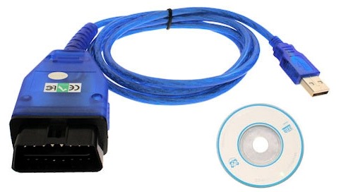

do i need to load any software apart from ducatidiag
the software that came with my blue vag usb cable was infected with a virus so i had to bin it.
I'm wondering if i'm just missing the driver for the blue cable :|

Post by DaveH »
twisty wrote:
DaveH wrote:do i need to load any software apart from ducatidiag
Hi Tom...you need to install the drivers for the cable before connecting it ..try the following link for the drivers
http://www.ftdichip.com/Drivers/D2XX.htm
Install the driver first
When you plug the cable in it should then set a virtual com port number - look in Control Panel/System/Hardware/Device Manager/Ports (COM & LPT) to see which port you need to set in the Ducatidiag software to enable communication.
Ignition off
Plug VAG cable into computer
Plug diag adapter into bike
Connect +ive terminal (I used the large cable connection on the solenoid just behind the radiator on the LHS of the bike)
Switch on ignition
Launch Ducatidiag
Reverse to disconnect....

is it the vcp driver i need or the d2xx one :?:
i feel like a learner here
DaveH
Posts: 113
Joined: 22 Apr 2010 22:07
Re: software
Post by DaveH »
VCP driver..:-)
