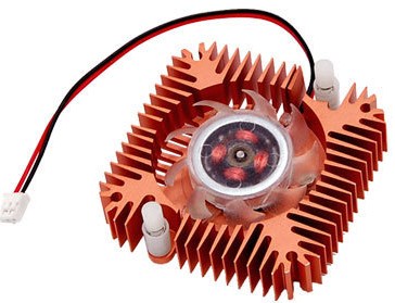

i'm going to fit one of these
on the rectifier with some thermal glue as i reckon there is too much heat in the tailpiece stuck between the cans.
Its a copper plated computer fan body ,2 wires, very small . less than a fiver.
