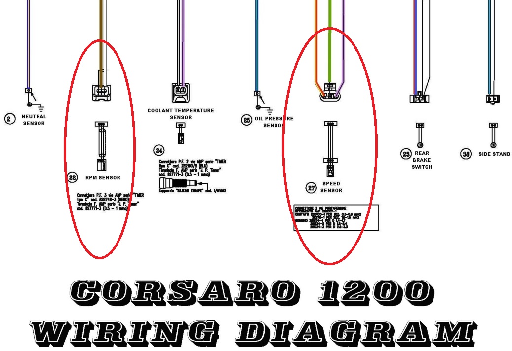

Hi All,
The 1200 is a bit new to me, so I'm looking for where to find the crank position sensor and ignition triggers, can't find them on my wiring diagram. Am I missing something?
Posts: 1081
Joined: 05 May 2006 13:47
Re: Ignition Trigger / Crank Position Sensor
Post by morini_tom »
Item 17

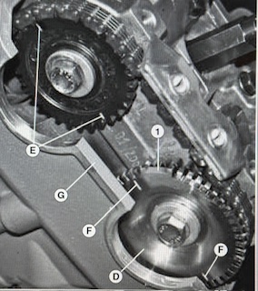

Yes, one of the cam gears has a trigger wheel on it so it gets speed from the trigger wheel teeth and there is a missing tooth which defines the rotational position.
The ECU then knows cam position and will double the speed for crank speed and calculate injection and ignition timing etc accordingly.
Not so different to the pickup on an aircooled Morini’s cam in that sense.
You can see the trigger wheel in this photo from the manual, with the missing tooth at (1)

So that one does both functions, crank position as well as speed?
The - so called - phonic wheel (D) e,g. the attached sensor does generate rpm values and ignition timing, the speedo sensor is located at the swing arm.
The rpm value is then sent from the ECU to the dashboard via CAN bus.
Furthermore the gear position is calculated by taking the rpm and speed infos.
rpm sensor.jpg (153.48 KiB) Viewed 55 times

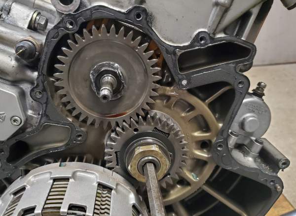

The cams are chain driven from an intermediate shaft, I can see, but what drives the intermediate shafts from the crankshaft? Is it gears?
Ebi
Posts: 9
Joined: 19 Sep 2016 06:19
Location: Stuttgart
Post by Ebi »
Do you have the workshop manual ? That helps a lot.
viewtopic.php?t=3840
