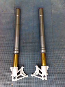

you mean something like this.
http://cgi.ebay.it/Forcella-marzocchi-r ... 51953a76de

twisty wrote:you mean something like this.
They sure would look good!
