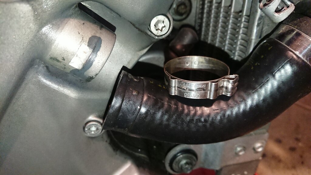

I changed coolant today and noticed this: there is a small groove on spigot. And this click-clip on the hose.
I read some topics, that there were problem with coolant hose slipping of the spigot. Is this some kind of factory upgrade which should eliminate this problem? Or is necesarry to do some more upgrade? I made only 2000km since I bought it, but never noticed any troble with this, any leakage or something...

The factory did an upgrade sometime between 2009 and 2013; my first Granpasso (2009 model) had the hose come loose in 2010 and dumped coolant all over a road outside Croydon, my second (a 2013 model bought "as new" from the factory in 2015) had the flange as shown. The original design looked really elegant with a small clip all that was holding the hose on to the engine and I had two Corsaros that never gave any problems in over 50,000 miles (both early models, but one chopped for the GP and the second a second hand extravagance some years later...)
It'd shouldn't need any alteration, but it's always worth keeping an eye on such things - although I have heard comments from some that say it can be difficult to remove water hose pipes... And yes, the current ZZ has done 14,000 miles now and I still keep a watchful eye!

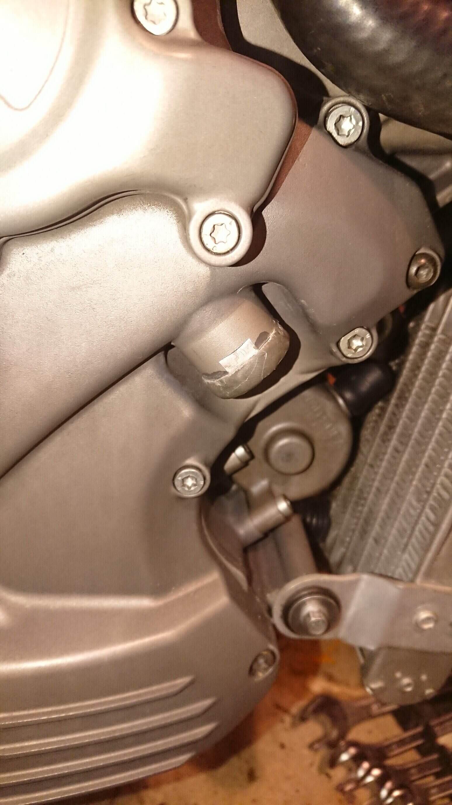

So in my case I have decided to make a low collar arround the edge of that spigot. It's not around entire spigot, maybe around half of it - as from rear side it is not possible to do it properly but... anyway - as barrier for that metal tie it is enough. I used some sort of liquid metal (i don't know correct english word for it), kind of 2 component epoxy material. It should be ok even with high temperatures, it's very hard and sticks to the base material really well.
It seems quite hopeful for me, let's face the real life this season and then check it again next winter.
Small update: I checked this "upgrade" after some time, but it seams that epoxy was not resistant to coolant. So I must find something else (PETEC power stahl not good).
