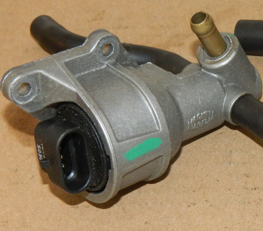

And may be anyone know how to disassemble a stepper motor? How to remowe sensor from motor body? Thanks
