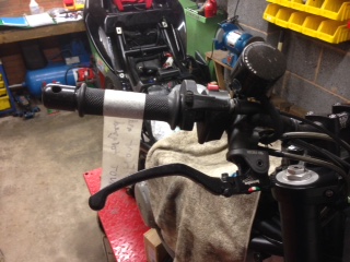

I have Brembo RCS 19 master cylinder. Works very well. Good feel and power. Adjustable ratio. I think it looks really cool too. I'm going over to do a bit on the bike on Wednesday so I'll measure the lever travel and report back.

Measured at the point on the lever where it's closest to the throttle cam case.
5mm until the switch engages, a further 10-15mm until there's any real pressure on the fluid. Another 10mm and you'd be stood on the front wheel.
For reference, that same point on the lever back to the throttle cam case is 45mm (although the levers are span adjustable)
Measuerments taken with the ratio set to give the most piston travel/least lever travel.
Jim

Well, the original brake set up on my bike sees the travel at 40mm before the serious bite kicks in. That's 10 mm later than the RCS set up & the margin that I find unnerving in terms of feel & ultimate response.
