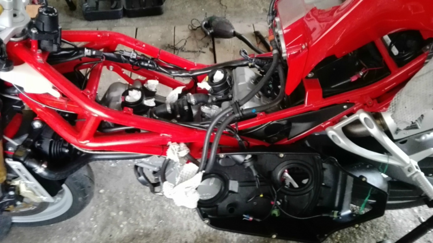

Thank you for the advice. Hitherto every stage of disassembly was easy. I am sure that the Assembly will be much heavier :shock:
Today I reached this level:

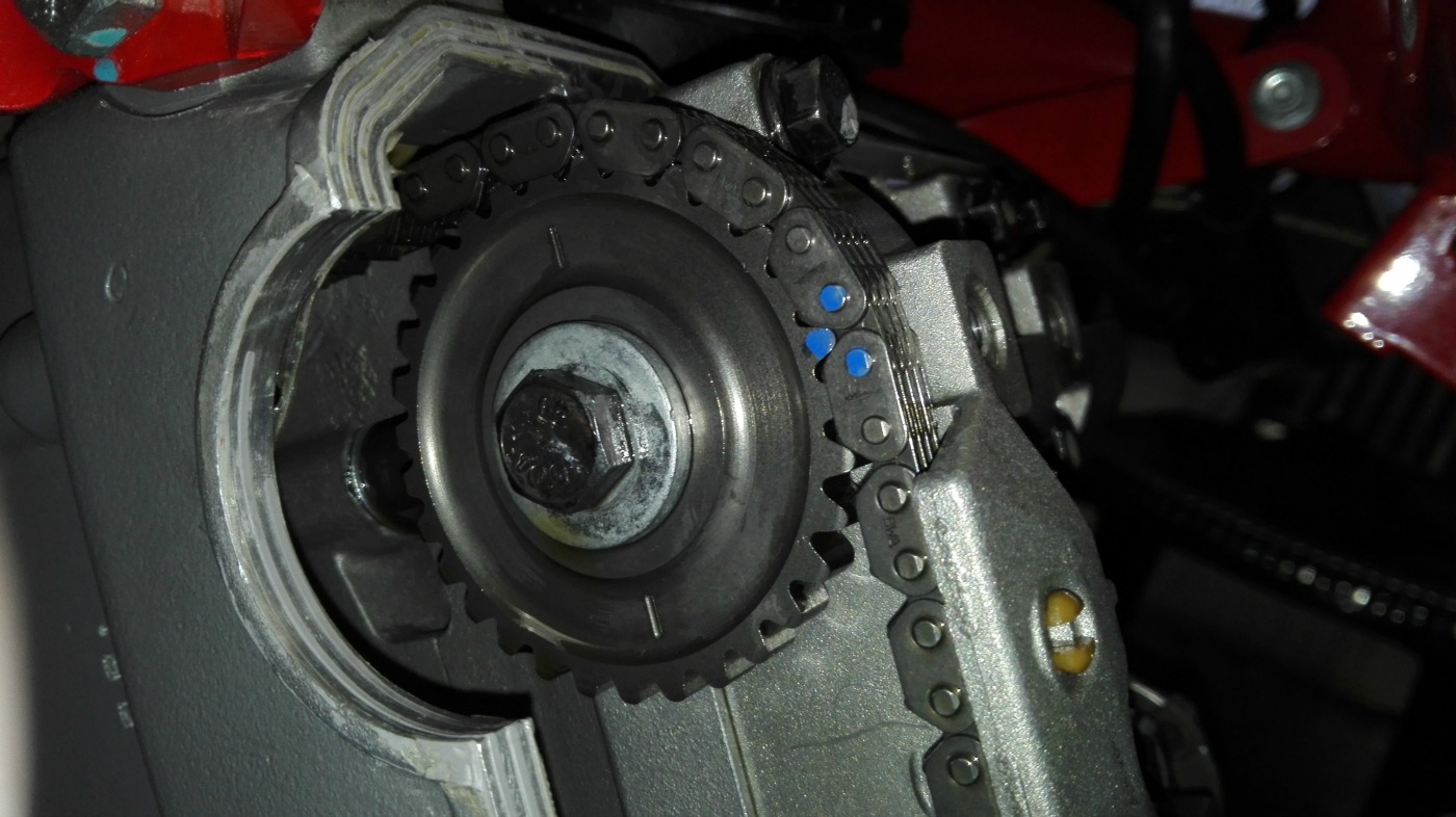

I have a small problem.
Now I disassembled only the first cylinder. The back is untouched.
I marked the cam-chain and the amid laying timing-gears with blue paint. I moved the engine to the OT by moving the back wheel with switched 6nd gear. After that I realized from he manual, that there is a small cap on the side ef the engine, and with a tool You can easily forward the engine. Then I turned over once or two times the engine.
My question: is it normal, that the marks dislocates, or could the reason of dislocation be that the cam-chain skipped a gear-teeth? I have a fear of skipping, because after pulling out the chain-tensioner, the chain easily come off from one or two teeths of the front gear.
How can I check whether the chain is on the right place of the gears? Should i disassemble the side-plate of the engine, or can it be done without it? (To be honest, I would not want to disassemble the side-engine cover.)
I haven an idea, take a marked wood-rod into he spark plug hole and watch the top-stand of the the piston (OT). In that stage the two lines on the two gears shuld be coincide with each other. Maybe at that stage could I fix the chain somehow.
Thank for the answers,
Tamas
Ralph
Posts: 226
Joined: 31 Jan 2009 10:12
Location: Fylde Coast NW United Kingdom
Re: Disasembly of Cylinder-head & replacing Valves and guide
Post by Ralph »
It is normal for The chain not mesh with the same teeth it's called hunting tooth it's to even out ware.
