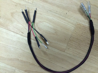

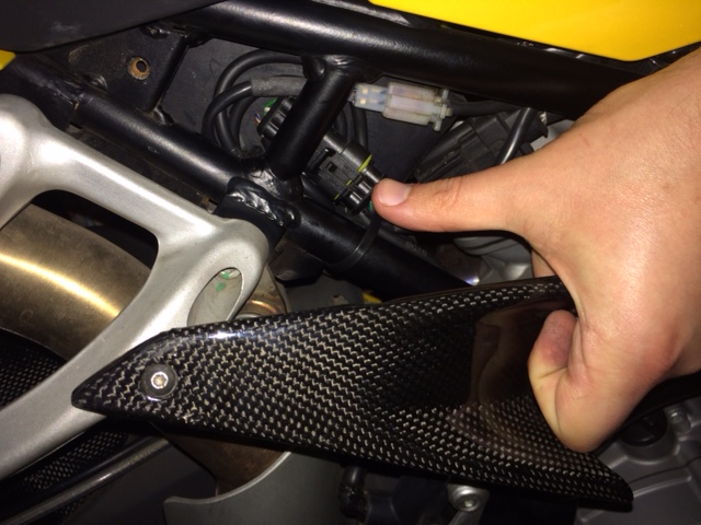

I had the dreaded failed speedo sensor at the weekend having changed the rear brake pads and also cleaned the bike, so wasn't sure if it was water ingress or disturbed sensor.
I found a neat way to check the sensor output and get mine working again which hopefully will help some of you with the same issue.
If you trace the wire from the sensor up the swingarm and frame, you will find it's connector, a 3 pin AMP Supaseal, is hidden underneath the triangular infill panel on the right hand side of the frame (on a Corsaro at least):
I made a simple loom up so that I could measure the voltages on the 3 wires without interfering with the bike's wiring loom or compromising the waterproof seals in the connector. The loom is just a link loom between the pins on the male and female connectors, with an extra wire spliced in to each wire so that the voltage can be measured. The AMP Supaseal connector pins are numbered 1 to 3 on the plastic connectors. I used red for +12V (pin 1), green for signal (pin 2), and black for -12V (pin 3)
I used AMP supaseal pins but didn't have a pair of 3 pin connectors, so insulated each pin to avoid short circuits. I'll buy a pair of connectors so that the loom is an easy and safe 'plug and play'. I used bullet connectors on my spliced wires which fit directly into my multimeter input, for handsfree measuring. And wires long enough to hang the multimeter on the rear pillion peg while working on the wheel speed sensor:
With the link loom connected, proceed as follows:
With the ignition switched on, you should read battery voltage (12-13V across your spliced pins 1 and 3). If you don't then you are not feeding the wheel speed sensor any voltage, so the problem lies somewhere else in the loom, maybe a fuse or maybe the speedo/rev counter unit or ECU itself (this wasn't the problem with mine so I didn't persue this fault path)
Next, connect the spliced pins 1 and 2 to your multimeter. You should see ~10V when the disc bolts are not in proximity of the wheel speed sensor, and as you rotate the rear wheel the voltage will step to battery voltage (~12-13V) as the bolt passes wheel speed sensor.
If you get ~10V the whole time then your wheel speed sensor is not seeing the bolts. Rotate the wheel until a bolt is in line with the speed sensor. You can then try the methods already discussed on the forum (electrical cleaner sprayed on the connector pins and down the speed sensor rubber boot, clean disc bolts, shim speed sensor, investigate cable routing), and when you see 12-13V on your multimeter you know you've found the issue.
I reckon it took me less time to make the loom, work out how to test it and fix the issue than it would have taken to put my bike gear on and go for a ride to check it.
It'll also be a really useful way of testing it in the garage when shiming the sensor after a wheel change etc.
