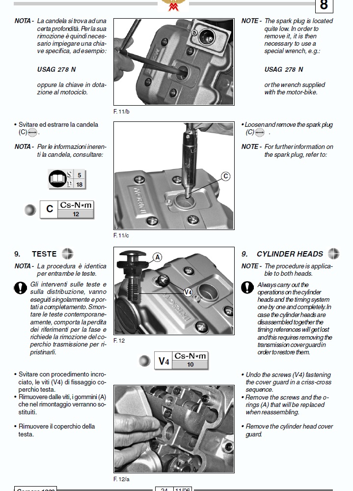

Good day! Please tell me how hard you need to tighten the four screws on the back cover? I did not find the manual information. Thank you.

Yes, 10Nm seems ok. Tip: look closely on the manual :lol:

Thank you. And where exactly is written about it?

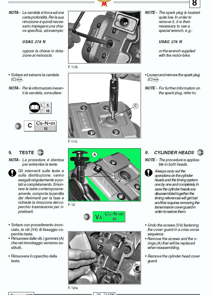

Fig 12 an corresponding v4 on screen you posted. I hope you mean the 4 screws holding the head cover.
