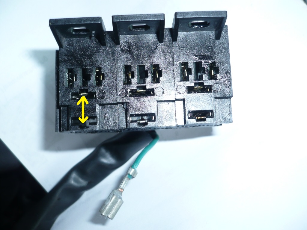

i don`t understand, which light does not work? low and high beam? both? please use "english" for your translation from russian!
the headlight-relays are activated by the speedometer.
first aid, you could remove the relays and bridge with a cable the wide contacts in the relay-socket. don`t forget to switch on ignition!
when the headlights light up, you have to check the way from the speedometer. i know that problem from many corsaros.
there very often the speedometer is faulty.
here the corsaro relay-socket, only as an example
