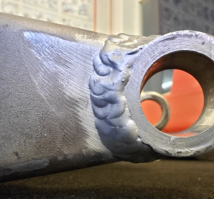

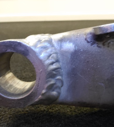

Update on the swingarm , I had bought a second hand swingarm from the lads at moto hub however on inspection the welds are exactly the same as my broken one so I decided to get mine repaired ( pictures to follow ) rather than brace the arm we went with building up the welds so they would work as the brace , I do have the OEM swingarm for sale if anybody would like to purchase it but I strongly advise to strengthen it , I can get the same fella to strengthen it , it would only cost an hours work he said, I have more confidence in this repaired one than I did in the OEM one

This shows just how off some of the welds are
