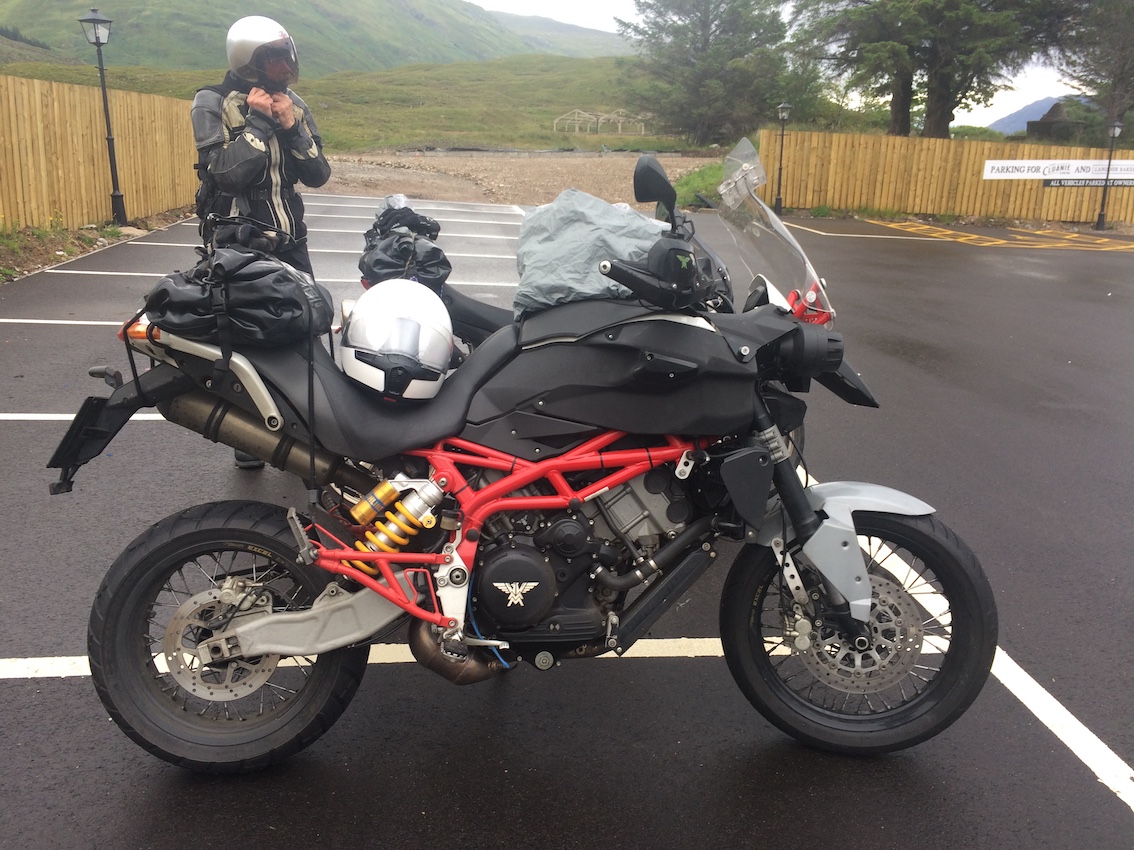

I was not aware of there rarity , see pic from Thursday in Glencoe, very wet but worth it.
