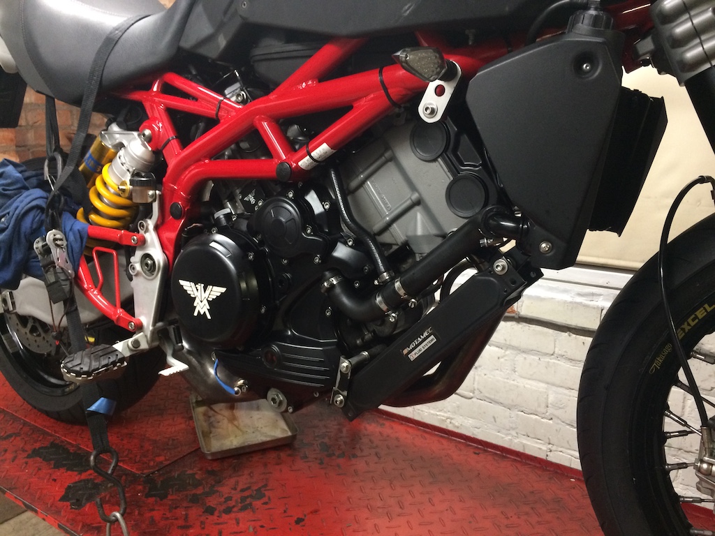

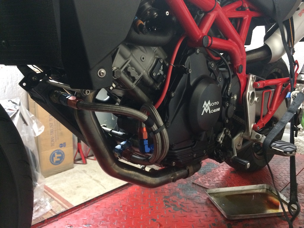

here is a pic of the oil cooler and plumbing
- GP2 OILCOOLERF
- IMG_3677.JPG (203.35 KiB) Viewed 16503 times
